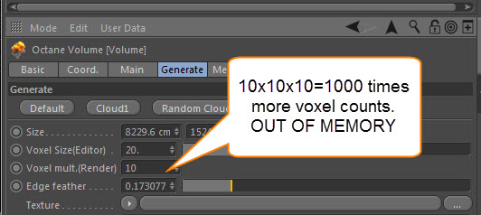

Yeah still not getting it. Took all Laubwerk textures out and used my own bark texture. Still crashes as soon as I try to render to the picture viewer. Can someone please take a look and tell me what's going on? Thank you!

aggiechase37 wrote:tell me what's going on?!
https://docs.otoy.com/#cinema-4d-v3-plu ... ume-object

Ok, so what options do I have? This is as large as I could make the voxels.
