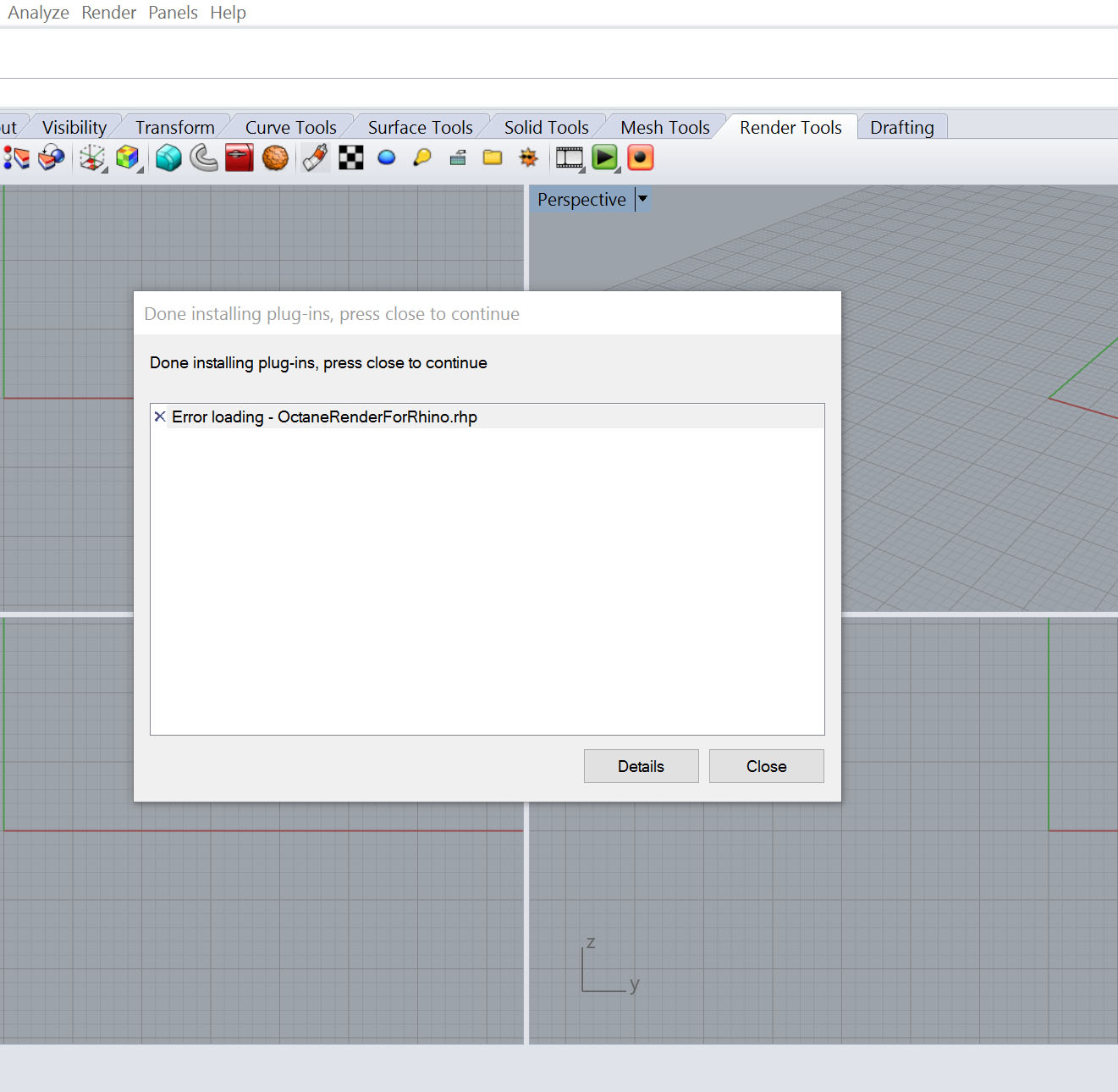

After uninstalling Rhino 6 and reloading it the exception message and the full crash of Rhino is no longer happening. Rhino 6 now cannot load Octane but Rhino 6 is working. Here is the message I get now.
cheers,
eric
Without knowing what the original exception is, it is very hard for me to help resolve your issue. If you ever have a problem like this, be sure to grab screenshots of all the errors so I can piece together what happened. I'm not sure how to get you up and running now. My only suggestion is to completely uninstall Rhino 6 and the Octane plugin and delete all residual files and start again.

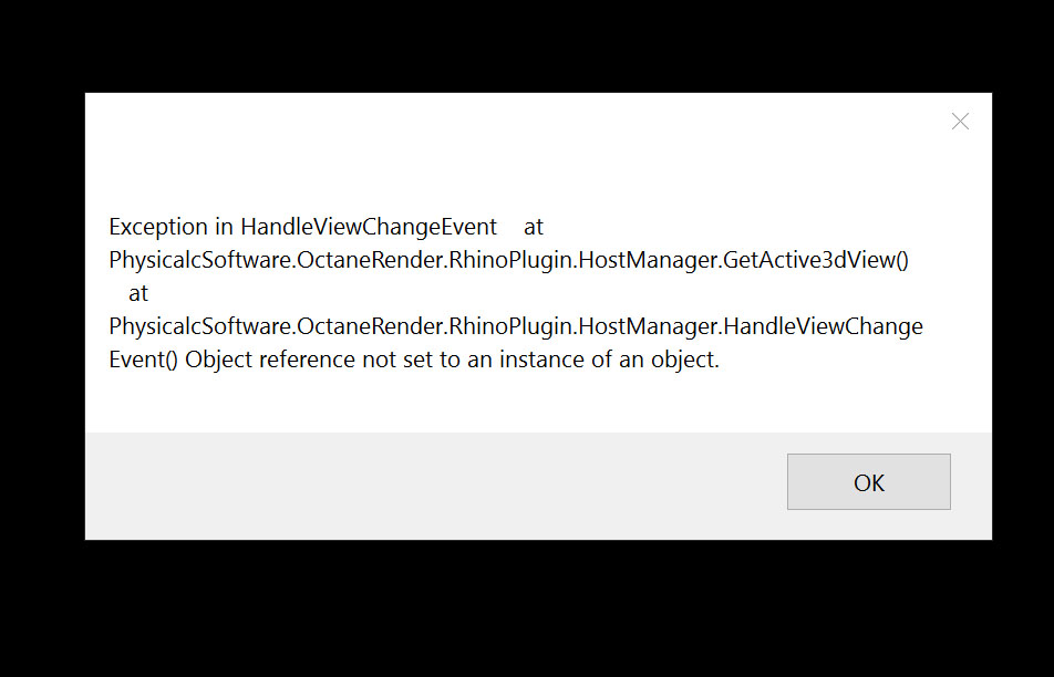

More information. I loaded Octane for R6 again and it worked fine the first time. The next time I opened R6 it would not run and I got the 'exception' message again ... attached.

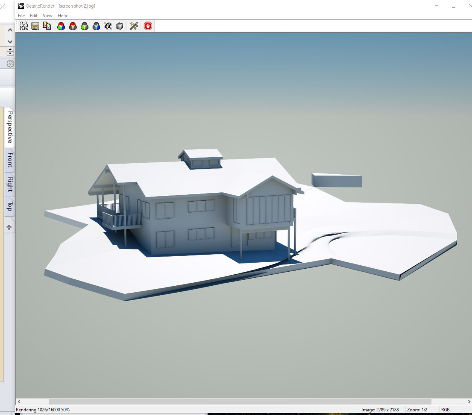

Another problem. Now Octane for R5 will only open a viewport with a resolution of 1439x516. No matter how I change the settings is is locked at that resolution. While it is rendering everything locks .. Rhino and Octane. I have to close the viewport to make any changes.
When I try to change resolution in the Octane window with the viewport itself turned off and the resolution unlocked I get the following message:
"Resolution is not locked. Lock the resolution or change the Viewport size to change the file resolution."
Changes I make to the settings do not change the viewport resolution. Baffled.

And here is what is happening with Rhino 5 ... This is the Viewport that comes up. I did manage to change the resolution but when it is running nothing else will respond at all ... I just get a little double beep when I click the mouse button.
The Viewport toolbar does not look right to me but the viewport says it is Octane
