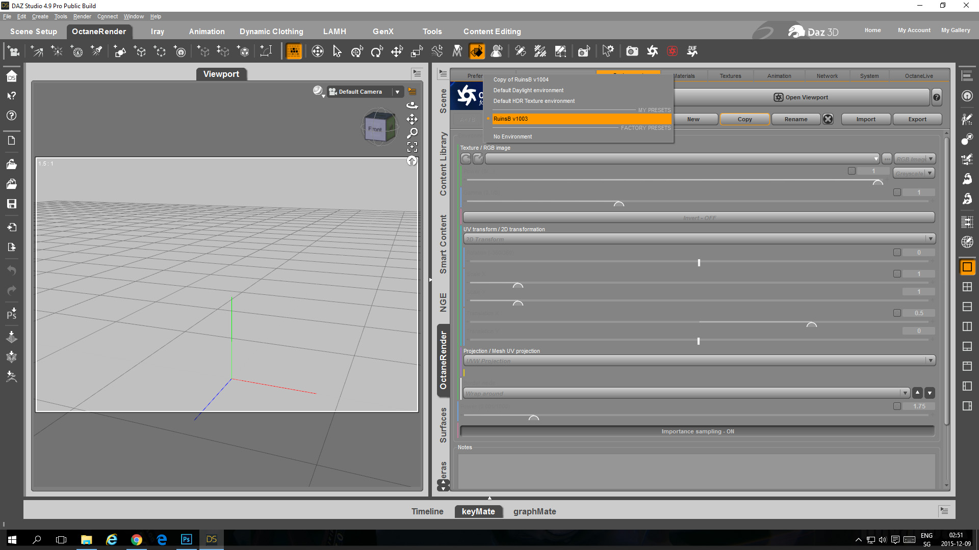

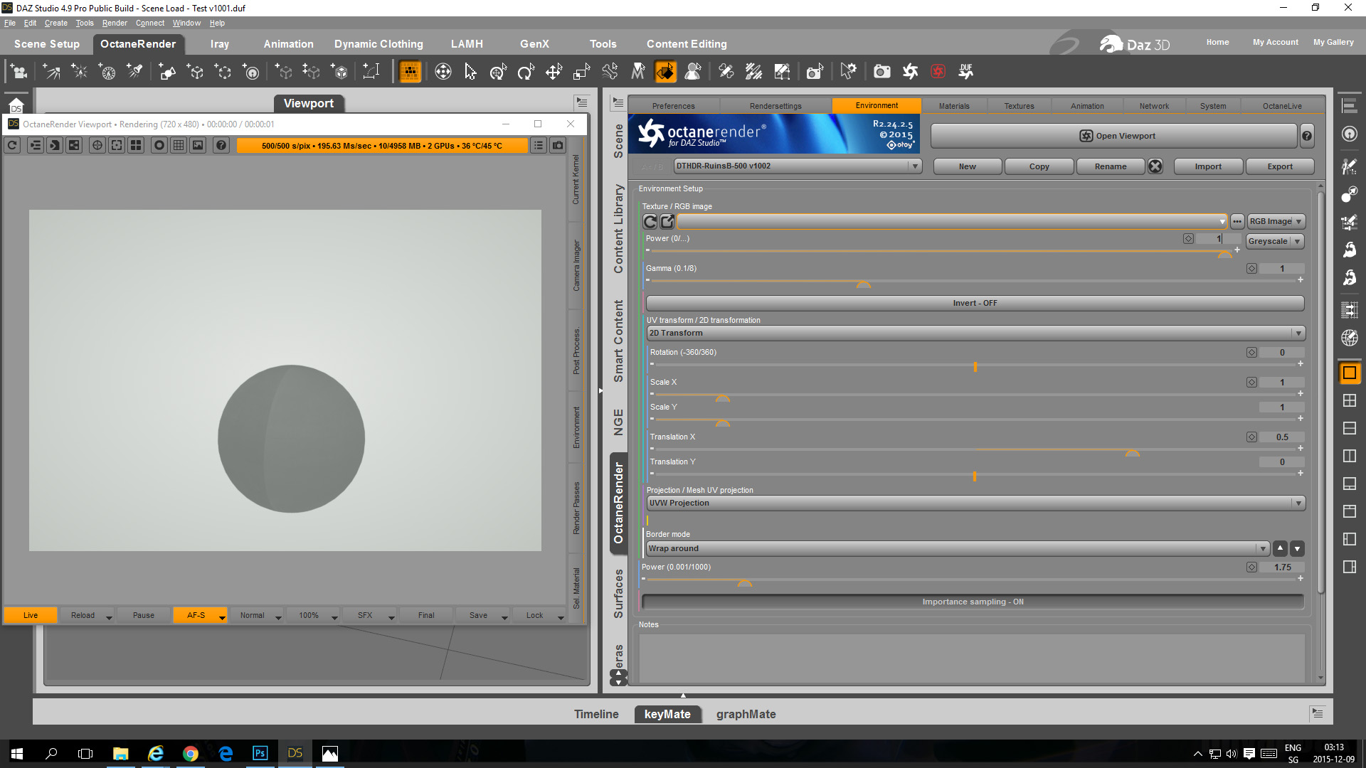

-Issue 1a) : the image used in the HDR environment preset is missing when a scene with an HDR environment is loaded
HDR environment - Image included in HDR environment is missing after loading a saved scene.jpg
- Issue 1b) :textures used in HDR environment presets that are saved to "My Presets" are also missing when loading

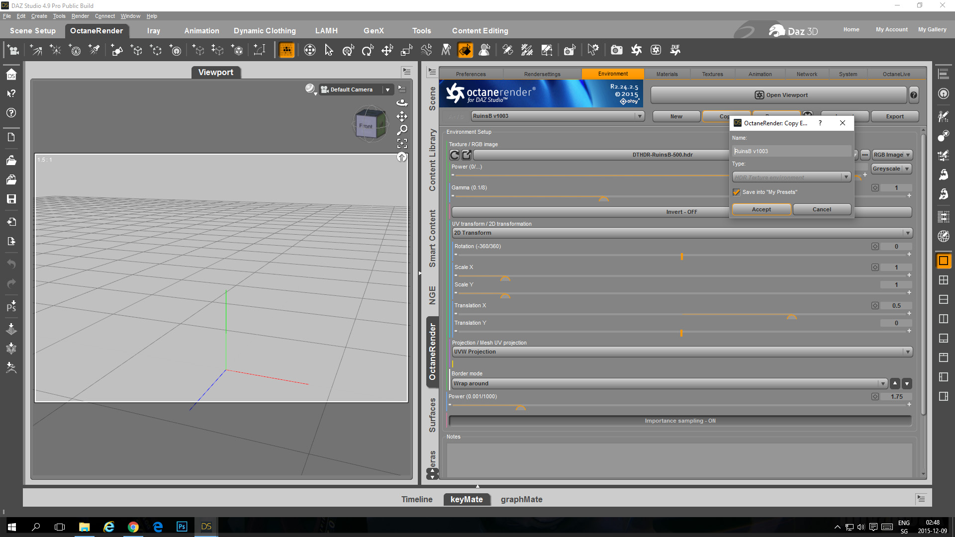

Workflow to replicate:
In the OcDS Environment tab
select default HDR environment preset
- change RGB color to RGB image
- in the texture load option browse to C:\Program Files\DAZ 3D\DAZStudio4 Public Build\shaders\iray\resources
- select DTHDR-RuinsB-500.hdr
- set Gamma to 1
- set Translation X to 0.5
- click on the "Copy" button
- enter name "Ruins v1003"
- set checkmark at "Save into "My Presets"" and accept
In DAZ Studio
- clear the scene by selecting /file/new
- load "Ruins v1003" from the "My Presets" section
The image is missing in the loaded preset.
