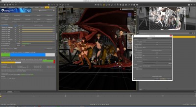

My scene has up to 7GB (a castle front wall, a dragon, a tiger armored, V4, V6, V7 and props).
I will recheck it on OR standalone to compare the memory (but remember that the scene is over 6GB) as all devices crash if OOC is not enable.
The bad news is that the use of OOC is not reliable on a low VRAM card on USB (1X) riser , as it slow down (depending on scene size) and almost freeze PC ! (need to be confirmed).
On amfeltec it only slow down but could render to final.

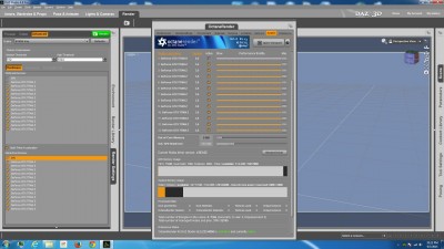

This is my scene memory and my settings So with big scene I will use only the Titan with OOC, even if titan black perform at 50%.
Only thing is resize textures with texture tab. But the settings are not saved.

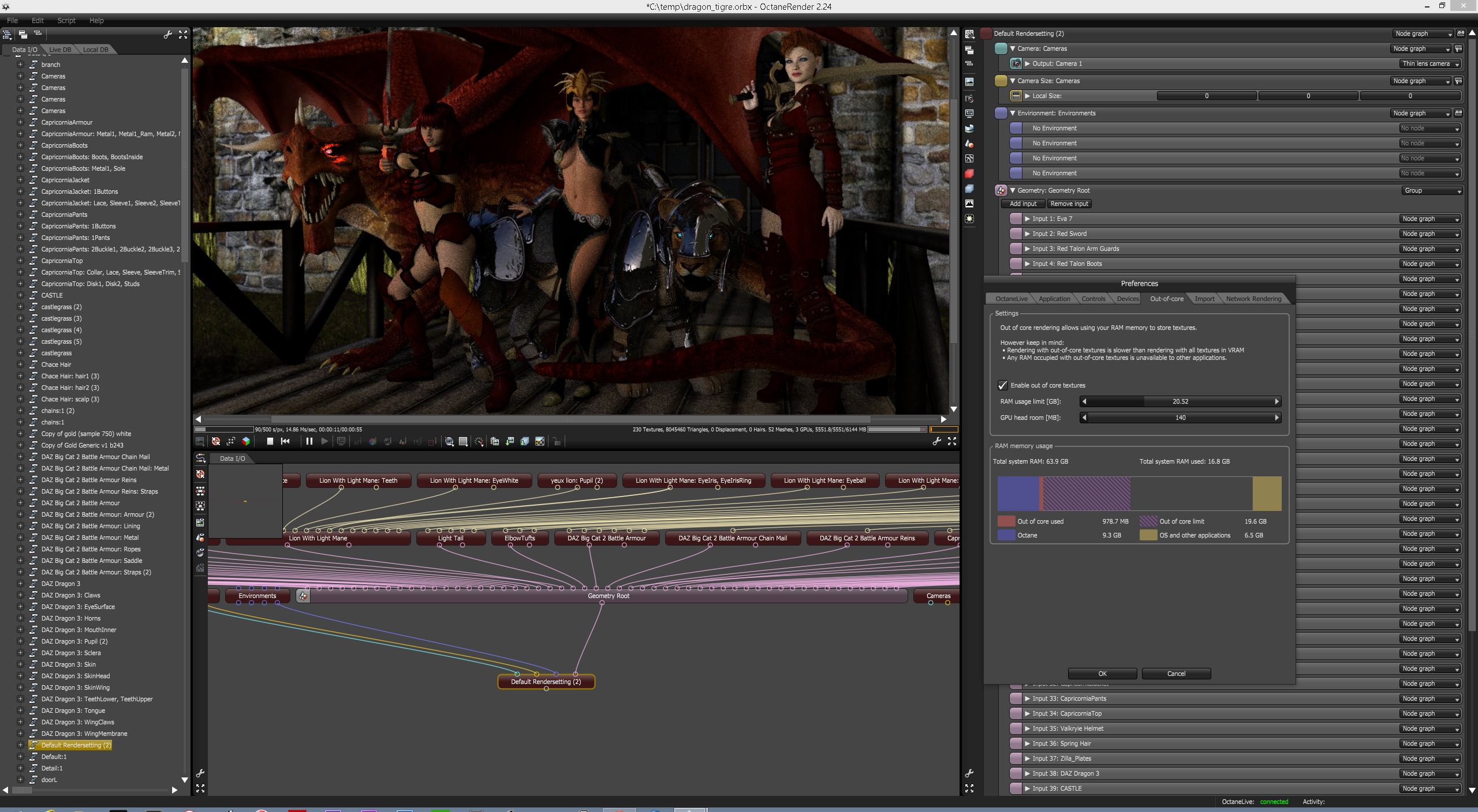

Hi Notiusweb,
Yes this scene crash my 6GB card until using OOC. I exported it to OR with orbx.
Same thing on OR standalone : need to enable OOC else render fail. But I notice that OOC need less RAM (978MB vs 1491MB).

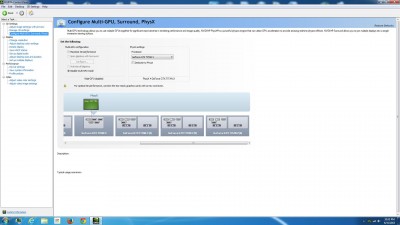

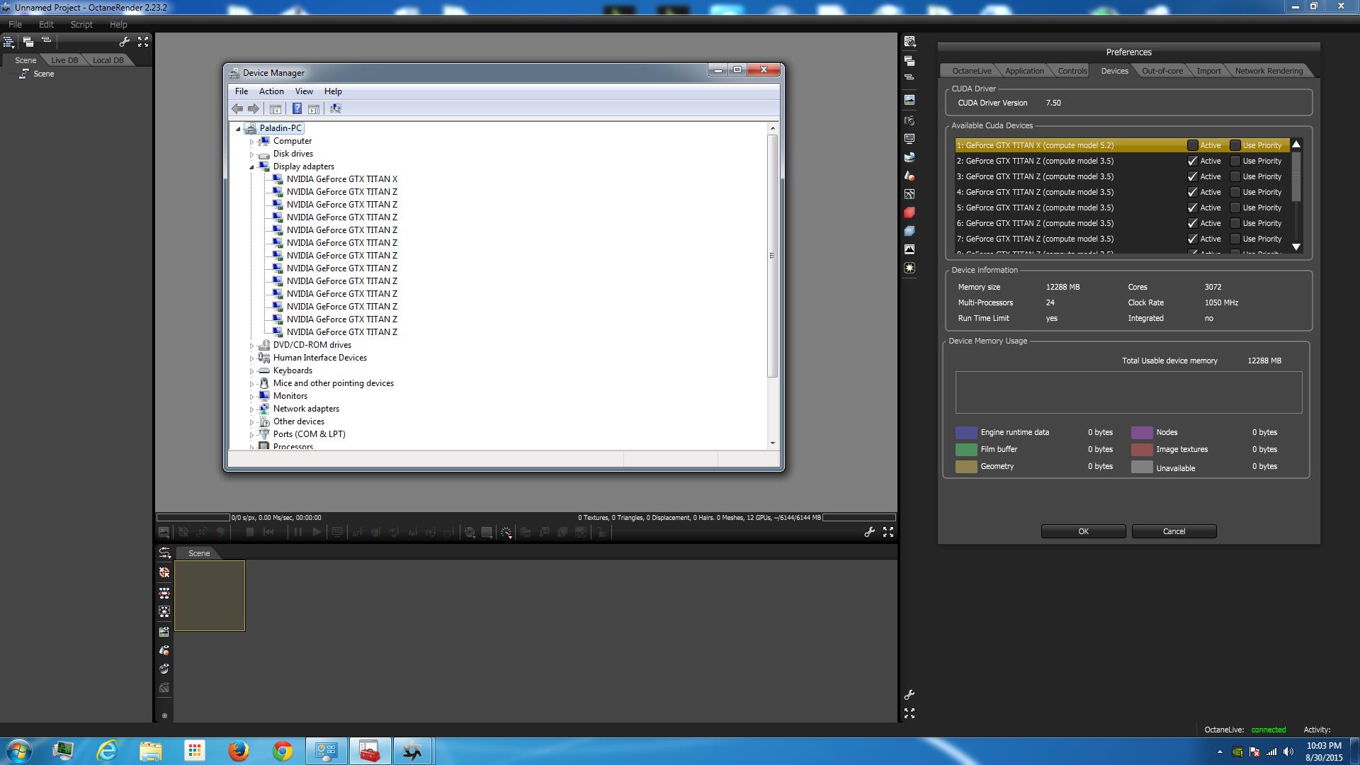

Hello all,
Just an update on my current setup, I didn't post it here, so here it is:
I disabled LSI storage controller in Southbridge (a secondary SATA interface), this looks to have freed up the PCIE lanes I needed, such that I have been able to successfully boot into Win 7 64 Bit with 13 GPU cores on the ASRock X79 Extreme 11.
Main Display Titan X direct on Mobo, 6 Titan Z on risers (3 the USB 3.0 PCIE risers/3 on the Amfeltec 4-way GPU Cluster). Running storage only off the motherboard's exclusive SATA ports.
Previously I could only boot with 10 GPU cores active. Once I got 11th GPU working, I added another Titan Z as I have been having success with these, giving me the 12th and 13th GPU cores (I considered 2 more Titan Xs, but felt I was capped at 6GB anyway...).

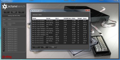

I attempted to post scores on Octane Bench however for some reason they are not uploading (I started a separate post to see if anyone could share thoughts on that.) It does let you select the full 13 GPU on Octane Bench, but it seems the scores match as if it were only 12. As such I am inclined to believe that it is only 12 that are being run in the benchmark even when you select 13.
I also put in a request to see if MSI Afterburner could allow up to and including 13 GPUs via its UI.
I have the Creative Soundblaster X-Fi soundcard still running for music production on my slot Lane 7, and both USB 2.0 and 3.0 ports are active. I have been using my old 660 Ti as the testing card for all this, contemplating that further experimenting may get 14 GPU. To summarize, I have a 1500 W for the Mobo, then 2 separate 1600 W EVGA external power supplies. One is extended to a separate electrical circuit via a 14 gauge extension chord.

Wow ! So much power !!!
You confirm the the limit of 12 GPU from octane render (same for network rendering). Hope that V3 break this limit !
