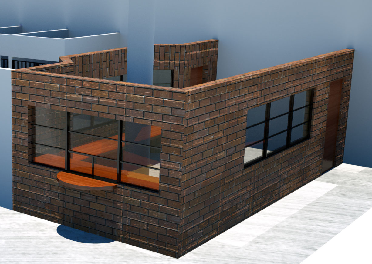

Hi Paul ...
Please have a look at the attached. Note that some of the brick are standing on end and that the front corner does not match. What can I do to correct these errors?
thanks,
eric
Can you send me the scene pls Eric?

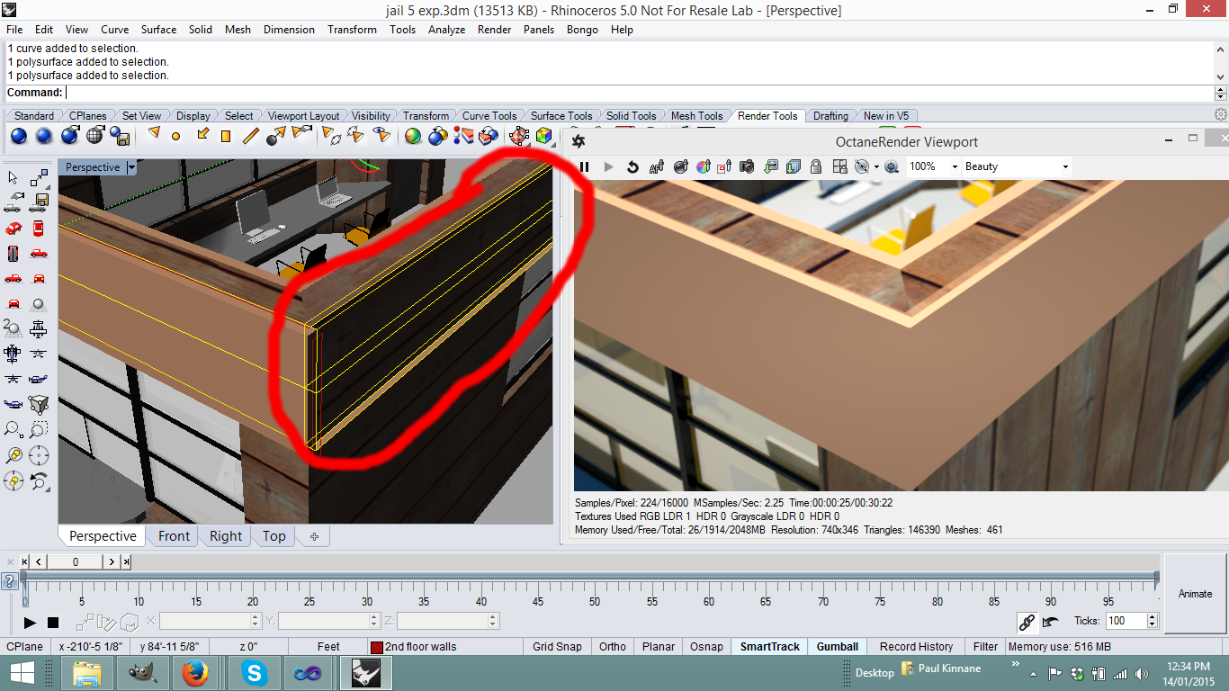

Hi Eric - I have had a look at your scene. I can't see any bricks "standing on end" in the render you posted. However I noticed a glitch in the geometry - the right hand upper rail (circled in red in the image below) is present in Rhino but missing in the Rhino render. It is rendering in Octane, but it means the Octane viewport is not matching the Rhino Rendered view.
Paul
