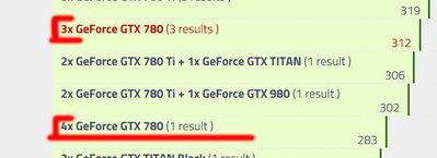

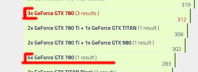

Looking at todays OctaneBench statistics I just realized how beneficial water cooling is. 3x780 on water perform 10% better than 4x780. An aircooled setup has 68% power of watercooled setup. Besides I had 35C at 1320Mhz 780 today.

smicha wrote:Looking at todays OctaneBench statistics I just realized how beneficial water cooling is. 3x780 on water perform 10% better than 4x780. An aircooled setup has 68% power of watercooled setup. Besides I had 35C at 1320Mhz 780 today.
Great finding, Sebastian! =)
I was expecting that =p

This is one very poor 4xGTX 780 result. I don't see it anymore in the result graph:
http://render.otoy.com/octanebench/summ ... 4x+GTX+780
Maybe those were 4 cards with stock air coolers stacked close together.
My result with 4 780s on air is 387.34 so speed improvement with water cooling is 7% per card.
Individually the cards can go up to score 100 ( the speed of 980 ) but when all 4 are on something is not right, maybe too much heat or too much voltage for PSUs to handle.

BorisGoreta wrote:This is one very poor 4xGTX 780 result. I don't see it anymore in the result graph:
Are your 780s close each other? Or on raiser? Are these 780s with stock fans or these are Strix that have non reference coolers?
Watercooling also gives silence and temps at load 35-45C.
