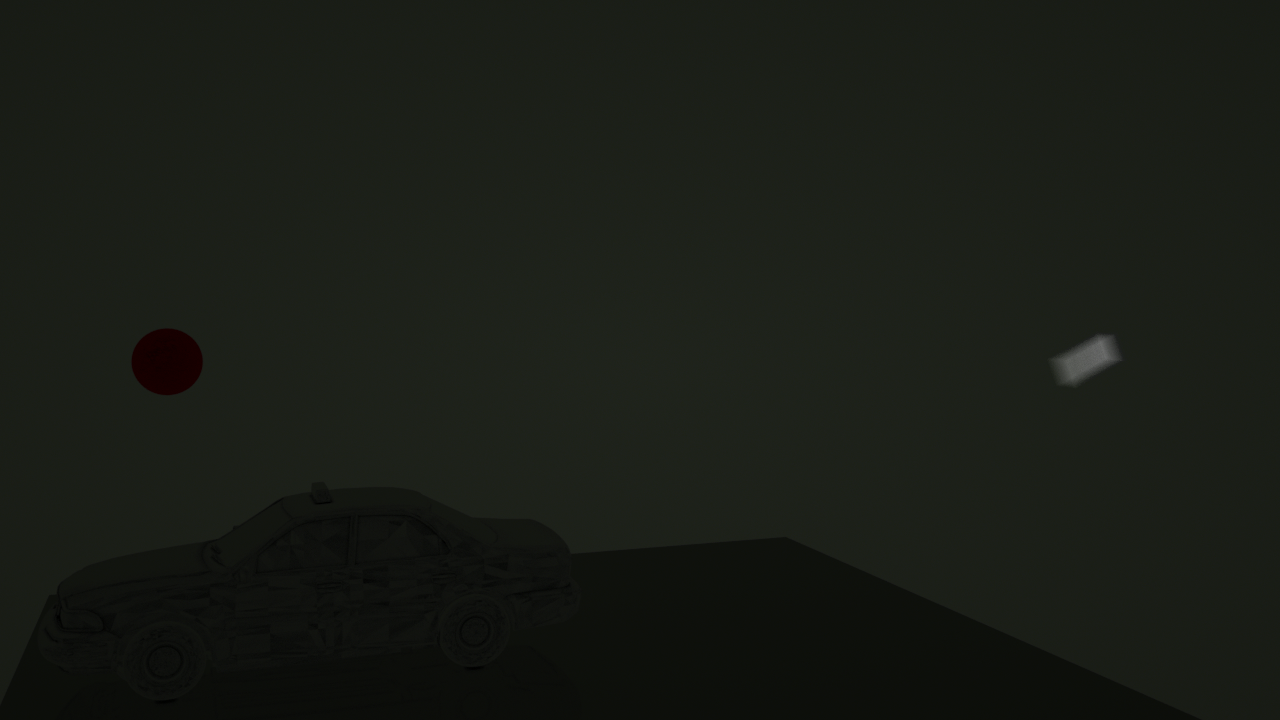

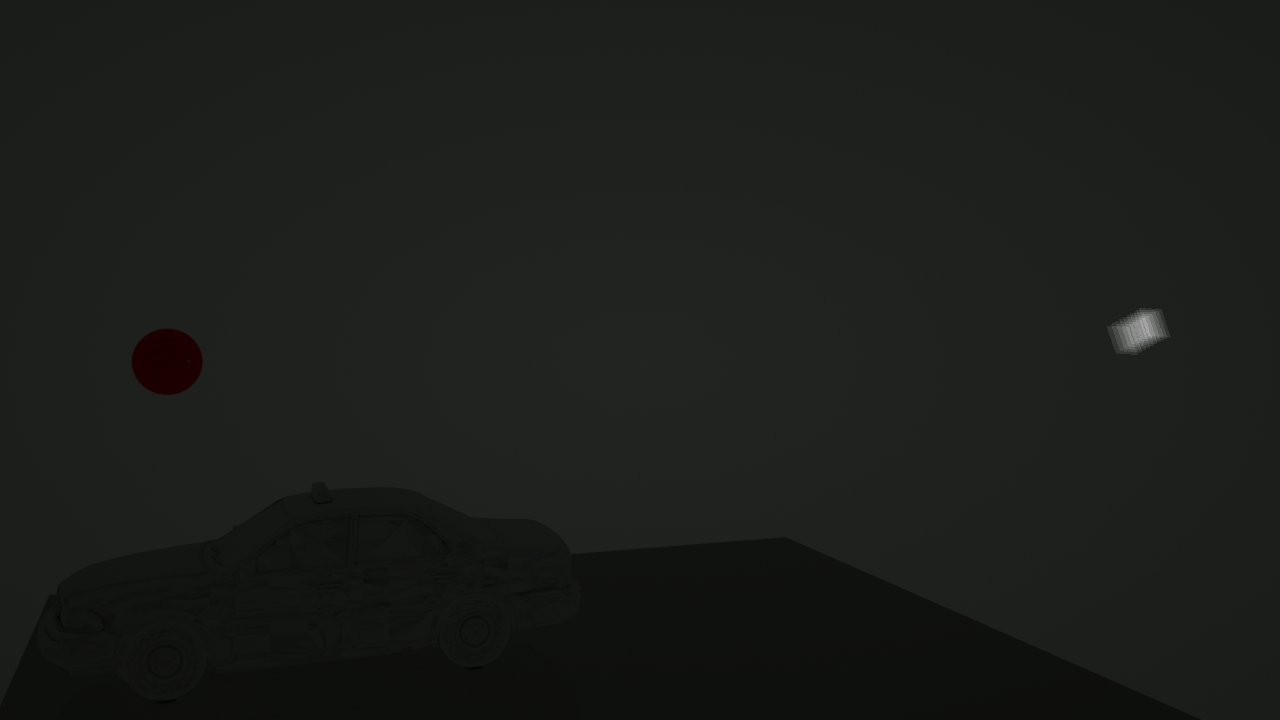

I've just measured it in Maya with stopwatch in hands:
So, the test scene is 57'775 tris, rendering 10 frames of animation (light moving in the scene), 10 subframes motion blur. As only the light source is moving in this scene, only this object is set as "Movable proxy", so only this object is reloaded by Maya plugin every frame, all others objects are loaded in the first frame only.
So, the results are:
- Animation without Motion blur enabled - 3:20 min for 10 frames animation.
- Animation with Motion blur enabled - 5:25 min for 10 frames animation.
So, it depends on exact scene settings, but anyway - the dependency is not linear. So for example for 10 subframes motion blur of 10 frames it is not 10 times slower, but less than just 1.64 times...
And the rendering itself it not longer at all - as each subframe renders the "samples per pixel" value divided by number of subframes. So, the resulting image's "samples per pixel" is the same as in "non motion blured" animation...

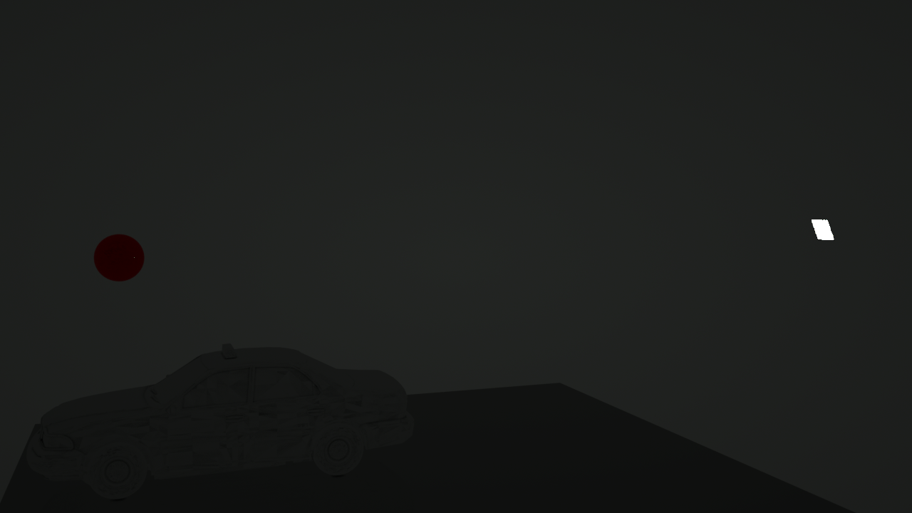

FrankPooleFloating wrote:Edit: Sorry, I just re-read TBFX's post again above.. it is a fancy gizmo.. oops. I was actually hoping that wasn't an Octane mo-blur... My guess (and hope) is that the Octane mo-blur is going to be silky smooth...
Here is your "silky smooth". Just depends on the motion blur settings in Maya. I've set the very simple variant for above posted testing, not even using the ability to set it differently for different frames and cameras...
