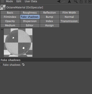

> mate: How to access/setup the new features of 1.20, such as architectural glass from within Cinema?
> aoktar: it's a switch which is name as "Fake Shadows" on specular materials .
hm. I cant find no such switch in the specular material
(c4doctane 0.73, macos)

indexofrefraction wrote:>hm. I cant find no such switch in the specular material
It's in the Attribute Manager when the material is selected.
Aoktar, does this Architectural Glass feature not work with Direct Lighting, only with Path Tracing/PMC?
ok found it, still have to report a bug:
the fake shadows tab is visible in the attribute editor when you select a material
but it is completely missing in the material settings window (when double clicking a material)

Yes, I also experience the same bug on my Mac.
indexofrefraction wrote:the fake shadows tab is visible in the attribute editor when you select a material

I cannot do visible "fake shadows". I''ll try to put some other place for next version.
