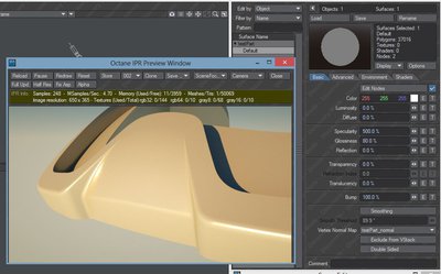

juanjgon wrote:
gristle wrote:Are LW vertex normal maps supported instead of using a smoothing angle?
I could not find anything in the docs about it. Pretty important for rendering models from CAD packages.
Got it running on 275 now, thanks Juanjo
I am working in the support of vertex normal maps, I hope to have it done soon, for the next plugin release.
-Juanjo
Plugin now support vertex normal maps, to be tested in the next release.
-Juanjo

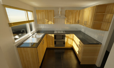

Just been playing with the plugin tonight, on an old kitchen model I did years ago. Something that would be useful is support for Lightwaves Limited Region, when setting up textures. Is that a possibility do you think?
juanjgon
Posts: 8867
Location: Spain
gordonrobb wrote:Just been playing with the plugin tonight, on an old kitchen model I did years ago. Something that would be useful is support for Lightwaves Limited Region, when setting up textures. Is that a possibility do you think?
Currently Octane doesn't support render region, I hope to see this feature in the Octane SDK soon.
-Juanjo
gordonrobb
Posts: 1247
Joined: Sat Mar 16, 2013 9:08 am
Here's that kitchen I was talking about. Let it cook overnight (excuse the pun), but my objective to try to get realistic reflections (blurred), and cuastic bounces. I'm very pleased with it. Although it did take me some time get my head around some of the texturing.
