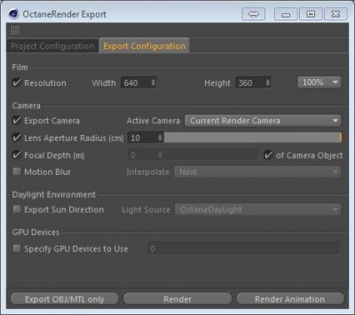

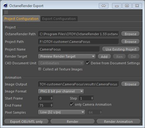

Posts: 10643
Hi cheeseburger,
I have just tried with the exporter and Octane 1.55 and everithing works as expected. In my opinion, you don't need to export the camera in Alembic, please have a look at the scene attached and at this screenshots about the proper settings:
CameraFocus_Exporter.7z
(337.47 KiB) Downloaded 1923 times
Here is the mov created with the exporter and octane v1.55:
CameraFocus.mp4
(361.22 KiB) Downloaded 52325 times
ciao beppe
cheeseburger
Posts: 61
Joined: Wed Apr 21, 2010 10:26 am
Ciao Bepe, Thanks so much for having a look at this and uploading those files. I couldn't see a camera where you had an object that controlled the focus distance ... just a key framed one is that right ?
Posts: 10643
Hi cheeseburger,
you have to animate with keyframes the Focus Distance in the c4d camera. If you want to use an object to control the focus, you need to switch to the integrated plugin.
ciao beppe
