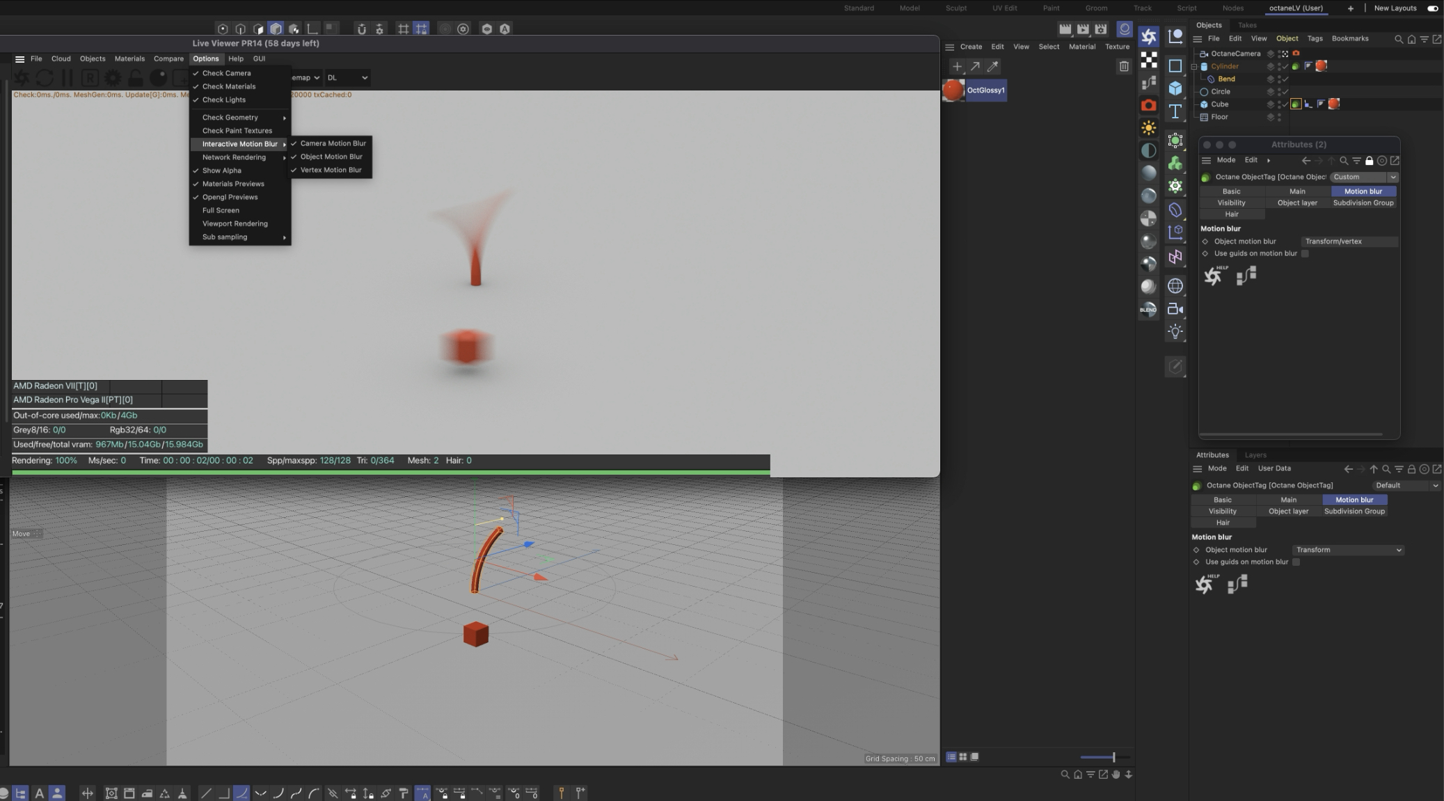

I'm having problems with Octane X not rendering motion blur. Has anyone else had this problem? I've literally set up the simplest test project 20 times now and can't make it show motion blur at all.
The octane camera has motion blur enabled. Shutter is open and there is an octane tag on a cube moving across the screen. No motion blur. It's kinda driving me crazy.
During my troubleshooting yesterday I got it to produce motion blur once. Not sure what I did and haven't been able to reproduce it.
Octane PR14 with R25, though I tried PR13 with R23 as well. Mac Pro with 3 VII's and a 580X, though I pulled out the 580X just to see if it would make a difference to have all matching cards. Still nothing.
Edit: I had a buddy with a PC send me over a simple test and it renders motion blur in the live viewer fine. However, if I make any new objects and add an object tag by right clicking, going to the drop down and adding an object tag, it does not render motion blur on the object. So what I've figured out is that it's the tag in the drop down. My work around is to just copy his tag to all my objects but still wondering how that tag got messed up. I've reinstalled the plugin and standalone at least 5 times now.
16 core Mac Pro. 32GB. 2 x GTX 690. C4D.

Posts: 10564
Hi itaki,
everything is working as expected here in PR14 R25, with Motion Blur in Live View :roll:
Please make sure that all the Motion Blur options are enabled in Live View menu Option/Interactive Motion Blur:
![](download/file.php?mode=view&id=87377)
ciao,
Beppe
