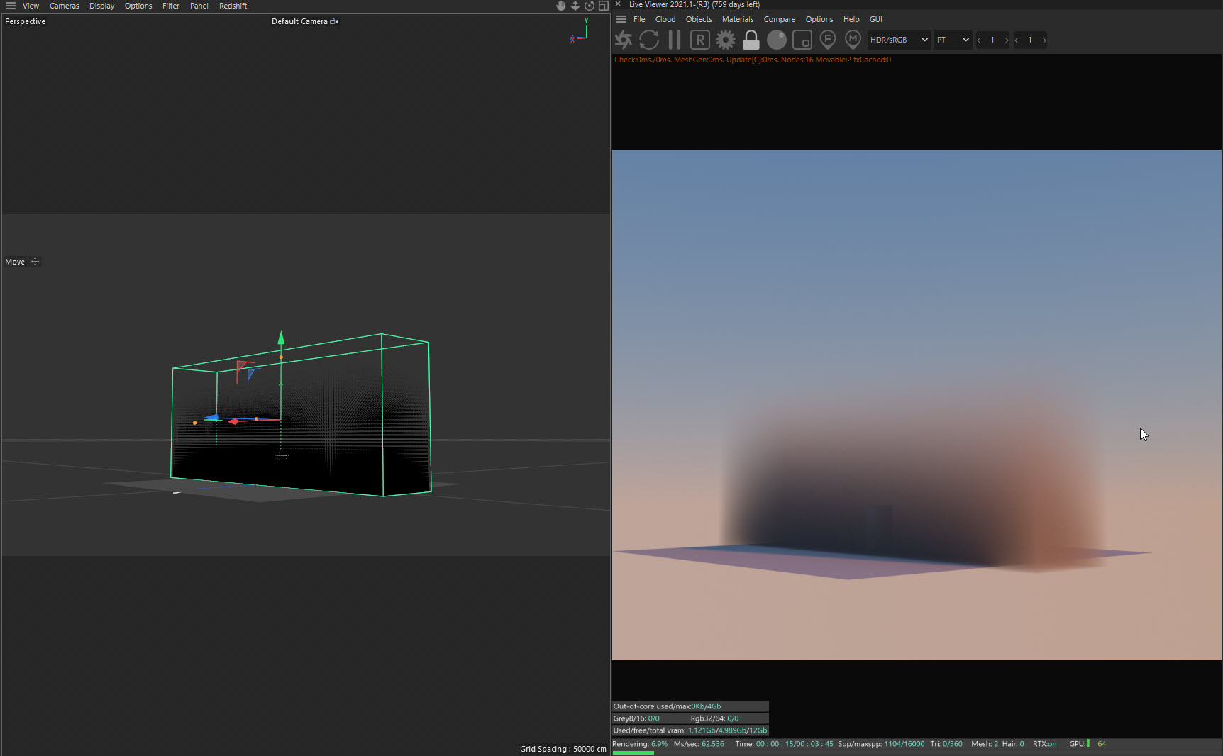

You can make better volumes, but you need to understand the limitations of shader sampling and volume settings. Needs to spend some time on these. Also don't go crazy on voxel counts for detailing the volumes, consider to use the medium textures and displacement effect.

aoktar wrote:You can make better volumes, but you need to understand the limitations of shader sampling and volume settings. Needs to spend some time on these. Also don't go crazy on voxel counts for detailing the volumes, consider to use the medium textures and displacement effect.
Thanks so much for sharing that, its great to see that it works :)

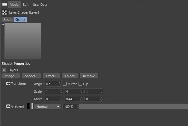

Definitely not intuitive at all, would of never guessed this with the transform (Id previously tried dozens of times to get what you shared), so wondered what this setup is doing that makes it work (and why a ramp on its own doesnt)?
Simply trying to understand the reason for this to implement in other larger setups...is there some sort of reason here or literally just stretching out the ramp?

This is the formula to sample the textures. But I think I can quickly add new mode to make it simpler
Code: Select all
                Float scl=0.01;
                Float z = iz*voxSize-0.5*boxSize.z+hSize;
                Float x = ix*voxSize-0.5*boxSize.x+hSize;
                Float y = iy*voxSize-0.5*boxSize.y+hSize;

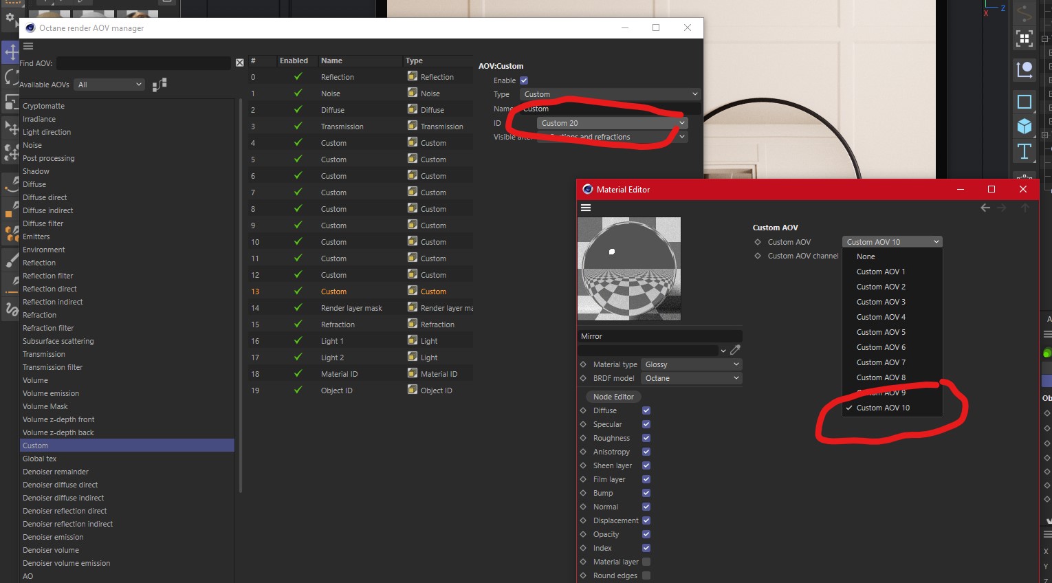

One question: shouldn't we be able to set up to 20 custom AOV in material's custom AOV tab? See attachment.

Yes, every part adjusted by hand. Seems like I missed that

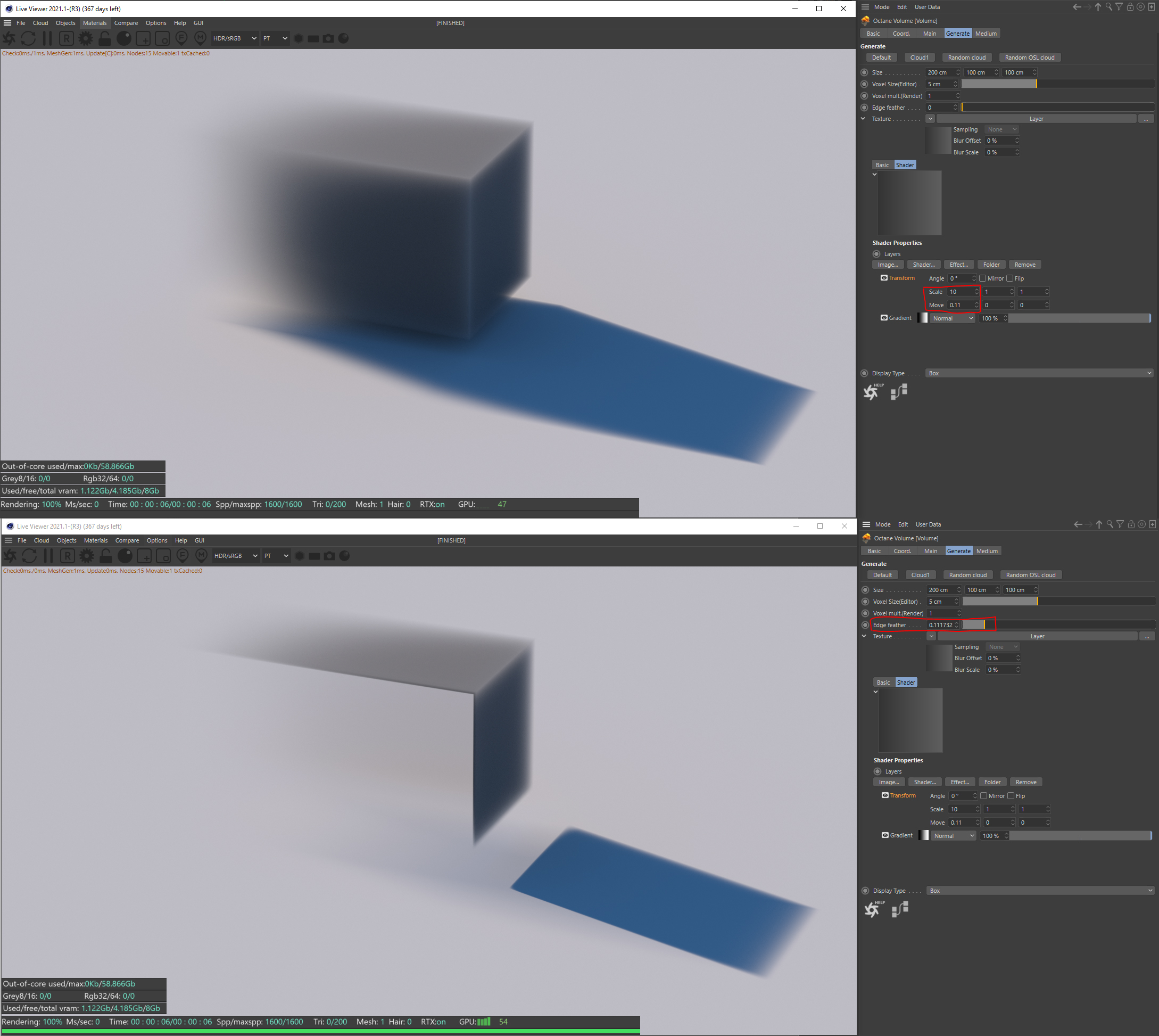

I used layers and a transform node, after which I actually managed to get a smooth gradient. Indeed, it would have been impossible to guess this oneself.
I also found a small bug. If you use a transform node and edges feathering, then a strange "disappeared wall" effect occurs. You can see this in the screenshots and in the video I recorded.
Video https://yadi.sk/i/Hp1dtjM-ctmNsw
It would be great if volumes with a gradient worked this way by default, without additional manipulation. Because now the three of us know how volumes work correctly and a few more people who will read our messages here, and all the other thousands of people will be deprived of this pleasure and will never know how to use volumes together with a gradient correctly.
