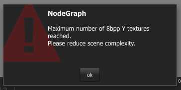

"NodeGraph
Maximum number of 8bpp Y textures reached.
Please reduce scene complexity."
Thank you NodeGraph for keeping me aware. But would you please explicit the limit number to avoid this next time?
edit : Ok, I dig into the problem and it seems to be limited to 64.
(http://www.refractivesoftware.com/forum ... bpp#p58562)
