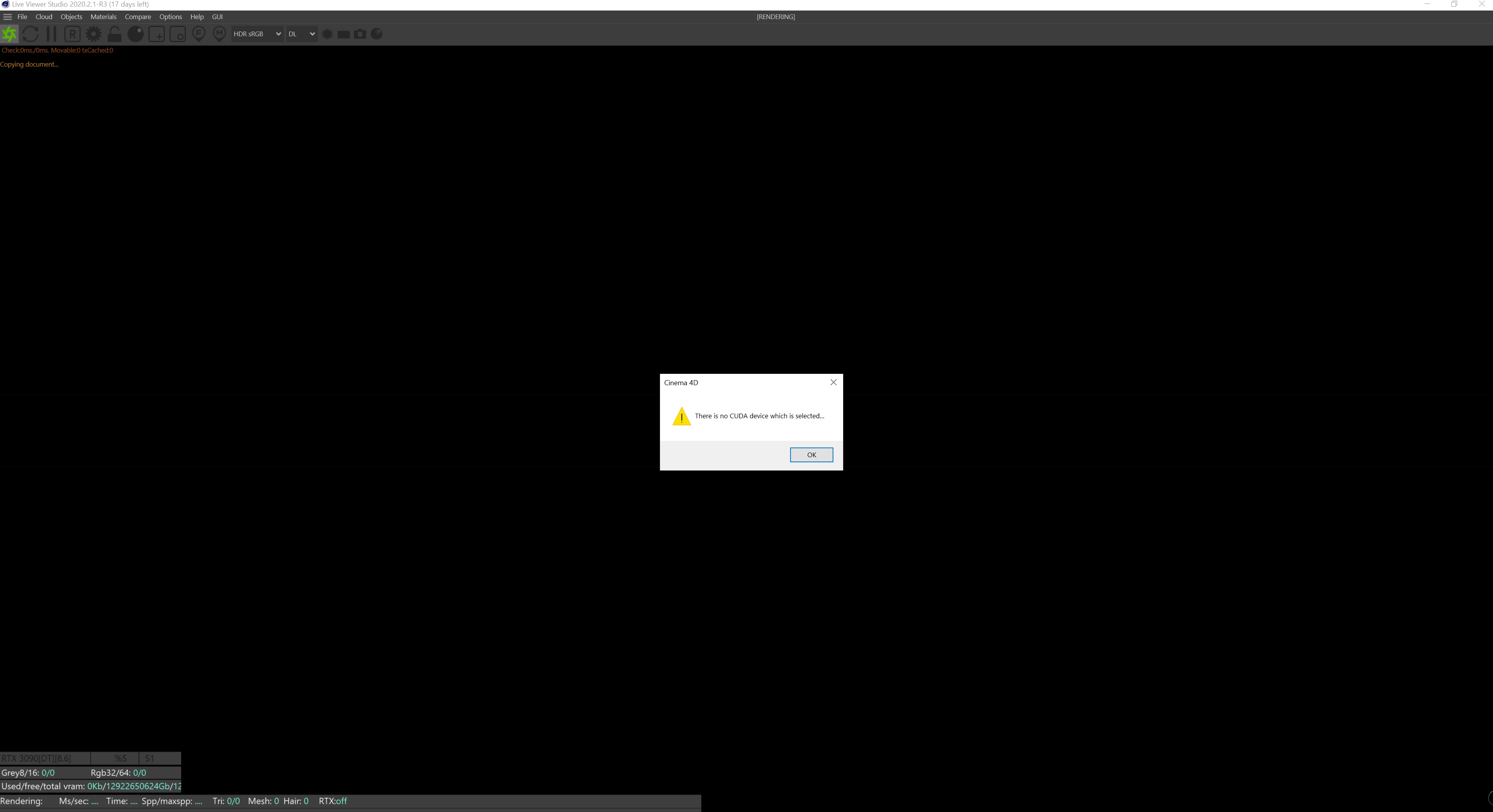

I am using Msi rtx 3090 I install and test, this is the result
Can you fix that ?
Posts: 16068
Location: Türkiye
vfxman83 wrote:Hi,
Can you fix that ?
What happen when you select 3090 in gpu settings?

vfxman83 wrote:I am using Msi rtx 3090 I install and test, this is the result
Did you try installing the Nvidia driver again?

vfxman83
Posts: 52
Joined: Sat Mar 22, 2014 6:07 pm
I checked nvidia driver I installed game ready version 460.89 I think I will change the driver version to SD latest driver

vfxman83 wrote:
I had this error message when I installed a new card but did not re-install the driver. After installing the same driver again, the error was gone.

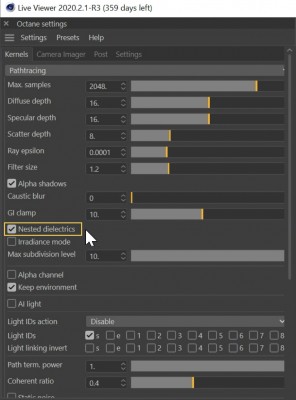

AaronWestwood wrote:Hey All!
Im new to the 2020.2.1 versions, but I just wondered was the scattering medium changed or altered?
When I open projects from the previous version all the scattering mediums within specular materials look different.
Totally cool if things were changed, just want to know what so I can get back the looks I created with other versions....
AW

Posts: 10606
Hi
@ vfxman83:
Please download and install 2020.2.1 Standalone.
You can find it by visiting your personal Downloads area:
https://render.otoy.com/account/download_archive.php
At first start, you will be asked to press the Download button, to automatically install a new cuDNN library to run 2020.2 versions correctly:
@ AaronWestwood:
There is a new Nested dielectrics option in Kernel settings, enabled by default now.
Try to disabler it with old scenes.
