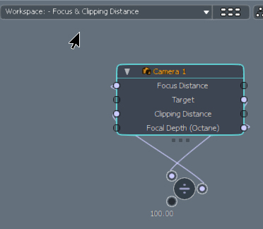

Attached is my scene. I was troubleshooting this scene myself found something which might make your job a bit easier. In the node graph, there's a workspace called 'Focus & Clipping Distance' where I have;
- Octanes Focal Depth driving Modos' Focus Distance
- Modo Cameras' Target Distance driving the same cameras' Clipping Distance
camera node.jpg (54.67 KiB) Viewed 27131 times
If you disconnect all these pins, you can then change the Custom LUT Strength without Octane IPR reloading.
