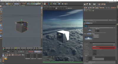

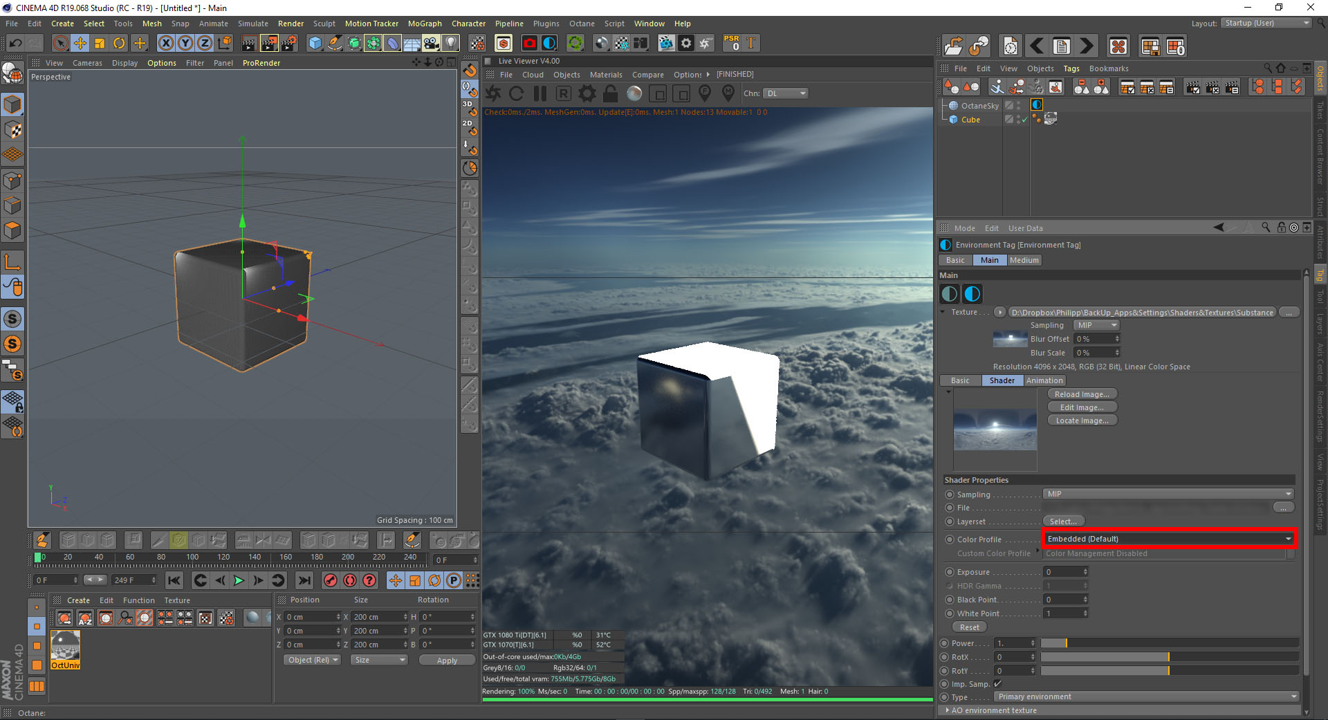

That's when happens when I just add the HDRI with a material that has even the slightest amount of roughness - burnt out highlights:
In this instance, the HDRI uses the embedded colour profile.

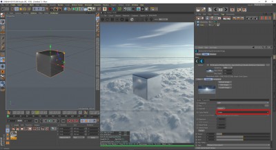

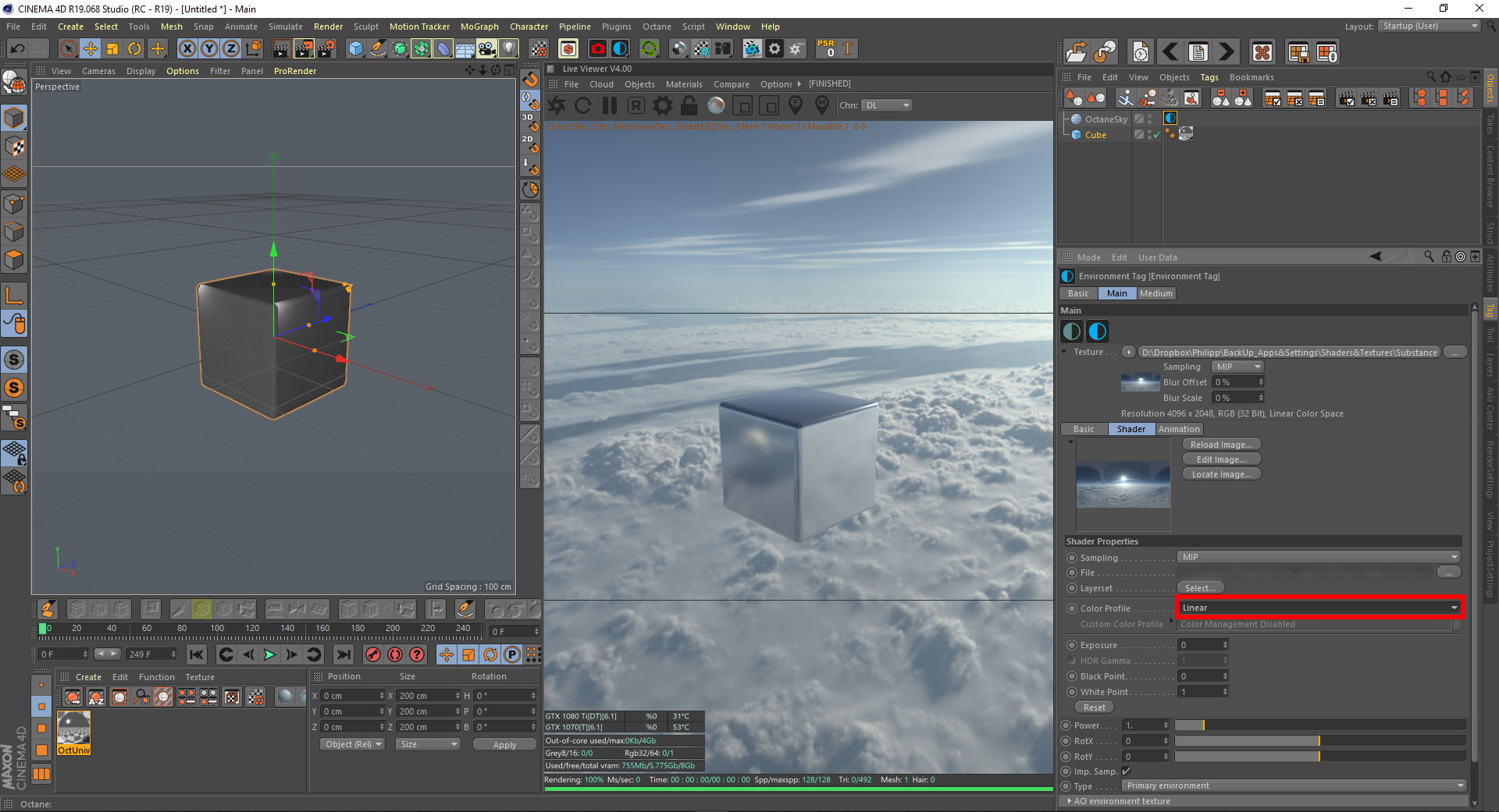

If I change the colour profile to linear however...
...the problem is gone.
So changing the colour profile fixed it, which I guess is what you meant by me using the wrong gamma - so thanks again!
