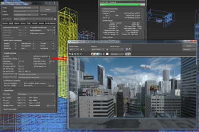

can you look into multiple phoenix grids and slow processing times each frame even though 2 grids have liquids sims of around 10 mb per sim only but why processing times gets to 3-4 times slower because of more than 1 phoenix grid.
in the image attached you can see actual rendering is about 20% the rest is loading every frame to slaves wasting 80% pf render time Not sure what is being loaded to slaves for so long since 2 liquid sims are only 20 mb per frame that need to be updated .

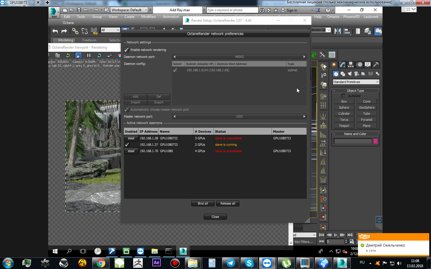

Also after activating the 4th slave with 4 more GPUs render time went from 1:34 to 2:17. Do you know why it got slower? is something wrong with the PC or network. It seems this forth slave makes it worse. 3 slaves are connected to the switch that is connected to the router and this 4th problematic slave is connected directly to the router like the master.

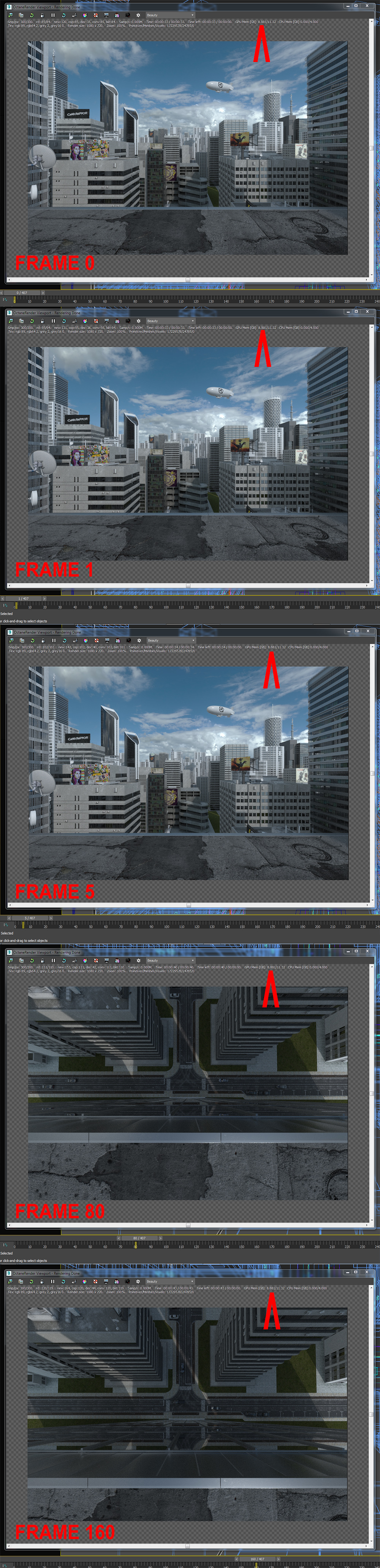

Hi Elvissuperstar007,Elvissuperstar007 wrote:every second frame stops!
memory is enough, exports to ORBX The render works but there can not be disabled MB
I uploaded you a video
scene loaded in the last post
1frame 7.784 Gb -next 2 frame 8.459 Gb -next 3 frame 7.784 Gb -next 4 frame 8.459 Gb ....... -next frame
I had to render each frame through a dynamic viewport! Make it possible to render the animation

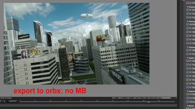

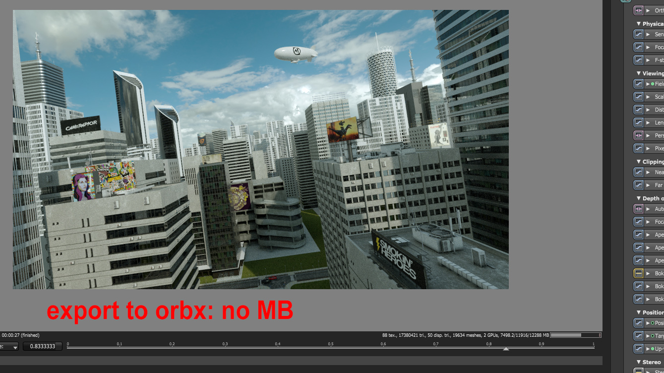

Hi Elvissuperstar007,Elvissuperstar007 wrote:why the camera MB is not disconnected! how can I remove it! exports to ORBX did not help
we do not need this scene MB
something issue seems to be in Octane properties between 3.06 and 3.07. MB, however, is set in Octane Render Setup> render setting
Regards
Paride

if you export ORBX stand.
25 frames and MB does not turn off
disable mb in 3dsMax before exporting to .orbx.
Regards
Paride

Hi coilbook,coilbook wrote:Hi Paride,
a. just a scene no phoenix: 42 seconds render time
b. scene + 1 liquid grid (10 mb per sim per frame) : 1 min 07 sec
c. scene +2 liquid grids : 1 min 34 sec
UPDATE:
Thank you
thanks
in the past I had issue using router, never issue with switch.
You could do this test:
connect switch to router and link master and slaves to router, how do you think?
With this configuration never had issue, using at least CAT6
Regards
