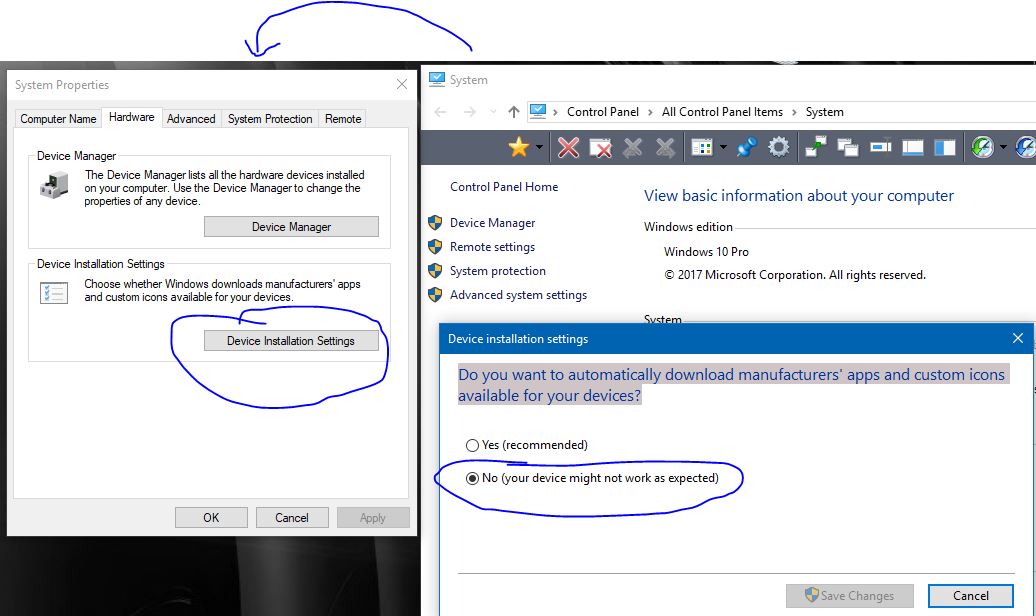

BCres
Posts: 246
Joined: Mon Feb 20, 2017 6:14 pm
Daniel,
It may be this selection in your system properties under the Hardware tab. It's windows 10 way of always updating drivers. If you know how to do this...turn it off (as shown) before you test the older driver.
That should keep windows from going back to the newer driver.

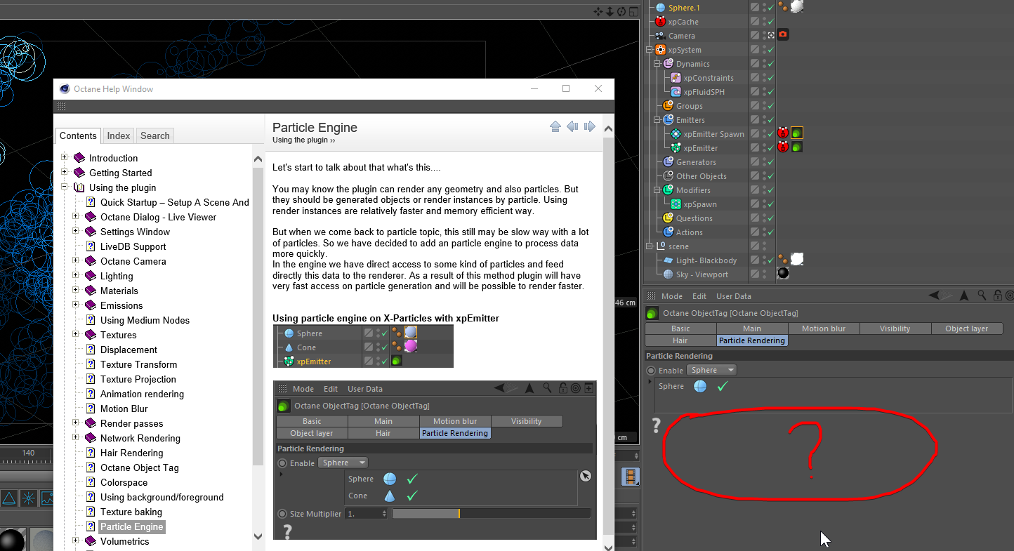

Posts: 301
Joined: Sat May 07, 2016 2:34 pm
Gone?
Win 10x64, AMD 1950x 16C/32T, RAM 32Gb, RTX 3060x3
Octane-for-C4D(R23.110)2021.x.x, Cycles4D, Centileo. Nvidia 472.47 STUDIO
divasoft
Posts: 349
Joined: Thu Jul 01, 2010 3:59 am
Location: Russia
VVG wrote:Gone?
No strength to endure all these bugs. So I moved to RedShift.
Posts: 16068
Location: Türkiye
VVG wrote:Gone?
Yes gone! I've removed this parameter. Thanks!
