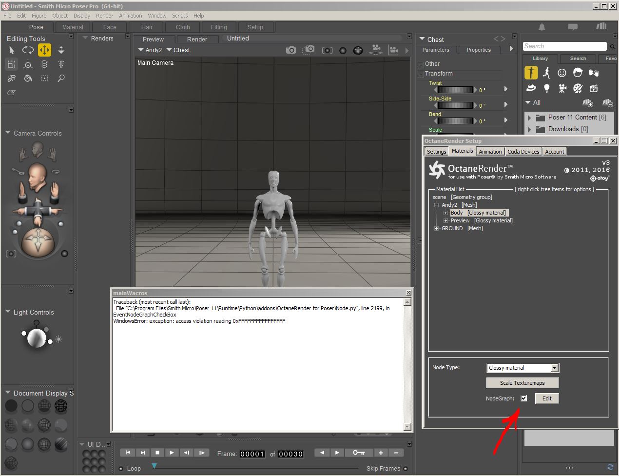

Since Paul is not getting errors, I'm hoping others in here can help me to fix this error I'm having with the Octane plugin.
I've spent a whole day to figure this one out but with no luck.
The specs:
Recently updated windows 7 64 bit.
Octane for Poser Plugin v. 3.7.0.85
Poser Pro 11 version 11.0.8.34338 - also tried with a 11.0.6 version with no luck
Driver 384.76 - also tried with a newer one (388.13) with no luck.
Poser Pro 11 is a clean fresh downloaded full install.
The error I'm getting is when using the Nodegraph. How to reproduce:
1. Select Andys body in the Material list.
2. Check the Nodegraph.
3. Uncheck the Nodegraph and click OK to "Re-imported Material Body from Poser".
4. If you check the Nodegraph again the first error should popup.
5. If you now hit the Edit button to enter the Nodegraph it should give you the second error.
Here is a video of the errors from my point of view.
error.wmv
Anybody got a clue to why I might get these errors?

I get the same error.
After the first error, I still can go in edit mode, but the second time pressing the edit node will pop up an error and not allow me to edit.
I am using Poser 11.0.8.34338, Windows 10 - 1709, b 16200.19, Nvidia 387.92 drivers for my 1080ti cards
But I found the culprit.....
After I disabled the DSON addon (moving it out of the Addon folder), the problem no longer occurs
So there is an incompatibility between the Octane plugin and DAZ's DSON plugin (Feb 5, 2014 .pyd date)

I was actually able to get a similar error whilst working on the Octane 3.08 version of the plugin. Click the Nodegraph checkbox, Click Edit, close the nodegraph window, Unclick the Nodegraph checkbox, then change the material type, and the error occurs. I will investigate further in the next few days.After I disabled the DSON addon (moving it out of the Addon folder), the problem no longer occurs

Thanks for checking. Mine is a clean install so I have no addons installed. Still a puzzle to me.wimvdb wrote:I get the same error.
Win 11 Pro | i5 12600K | 32GB ram | 2x GTX 1080Ti + 3080Ti - studio driver 581.57| Modo/Blender/ZBrush/Daz/Poser
Just to be sure - Did you check the addon folder?Zay wrote:Thanks for checking. Mine is a clean install so I have no addons installed. Still a puzzle to me.wimvdb wrote:I get the same error.
A clean install will not remove it. So if you install in the same location (and you have not deleted the folder), old addons will still be there.
The Poser installer will only remove the files it know it has installed.
Configuration: Windows 11 Pro, I9 12900K, 128GB, RTX 3090, P12 b1029
