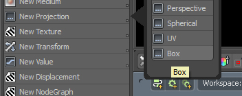

Dino,
do you mean box projection?

Ah, sneaky., missed that. Cheers Smicha.smicha wrote:MrFurious wrote:Hi Paul, was wondering if 'box' mapping will be supported anytime soon? I'm sure I recall with version 2xx of the plugin Cubic mapping wasn't implemented yet, but I was able to use Box mapping.

Any way to feed in the Modo Box projection values into the octane one?
