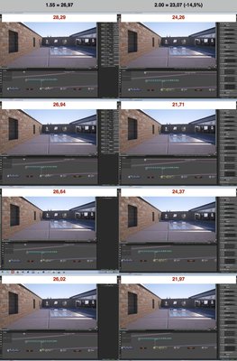

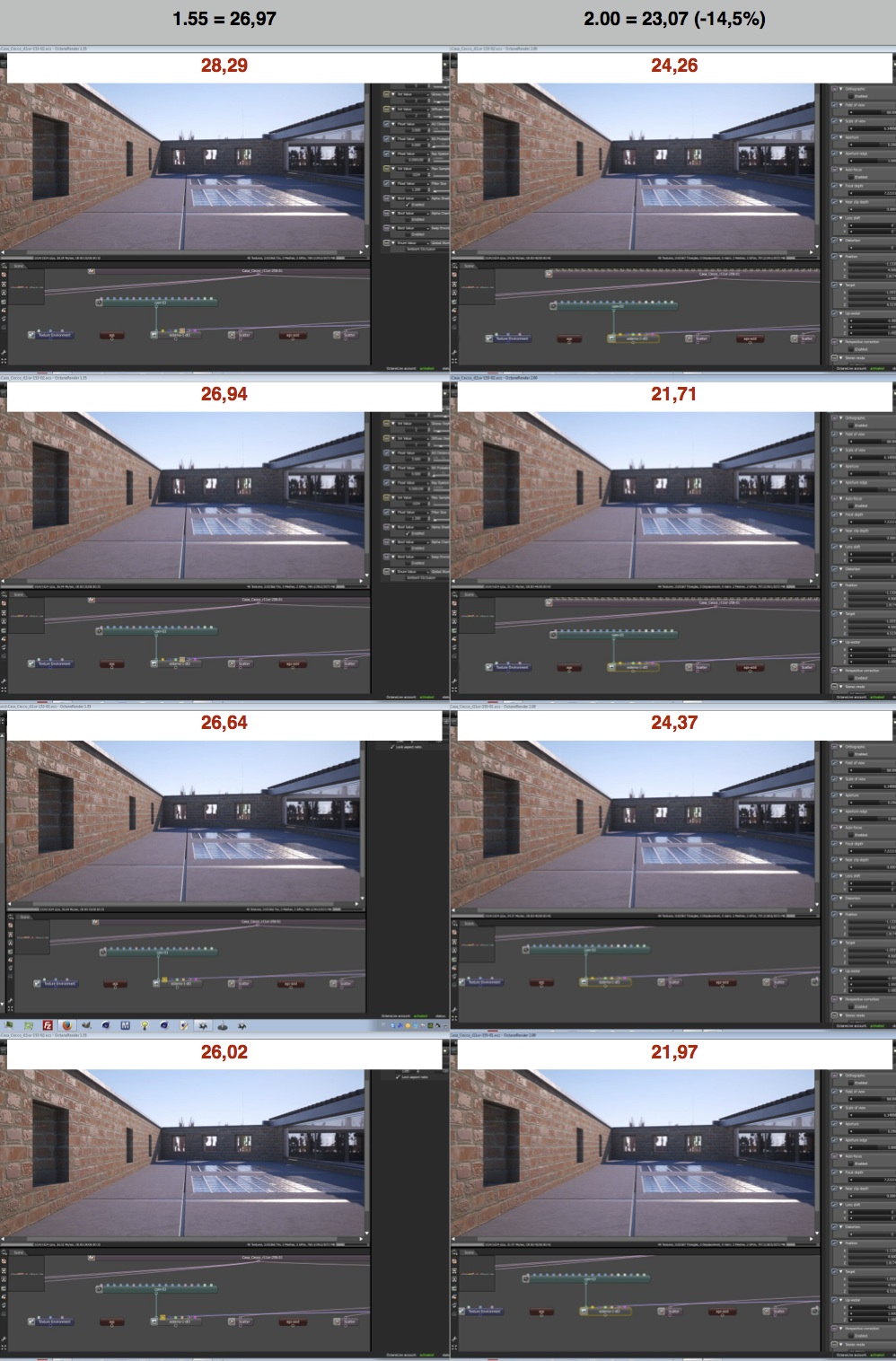

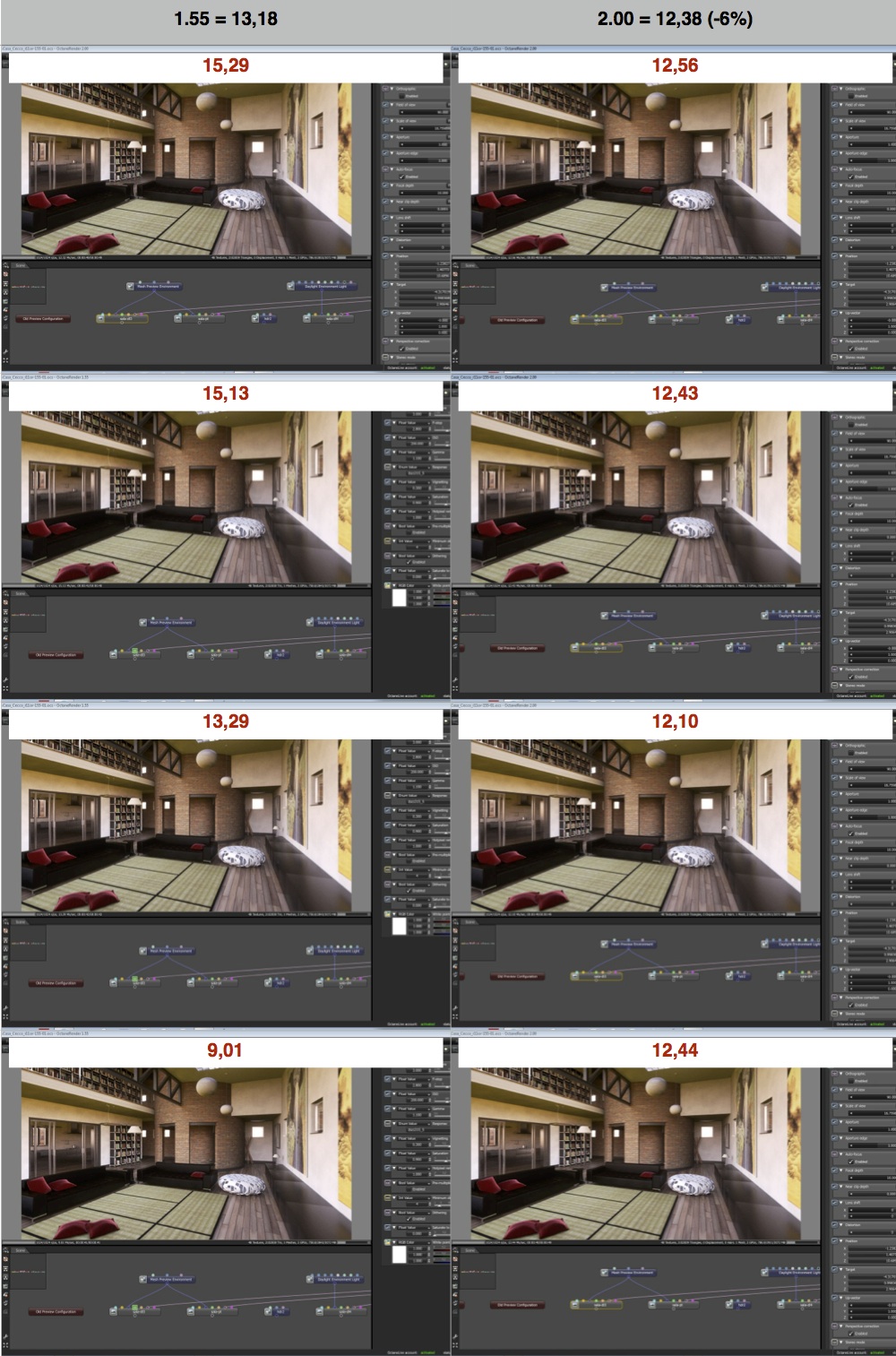

hi,
i'm one of the beta tester of octane render 2.0
here is a speed test comparison between v1.55 and v2.00 with a dual GTX 780 setup. It's the same file with about 2k polys and two different render target, one in exterior with sun light and another one in interior with hdri.
the test is done with Direct light kernel in AO mode since in the Path Tracing and PMC kernel there is a new parameter for "Specular depth" that is not present in the 1.55.
since the sampling/pixel value is a bit erratic, i have pressed 4 times the "resume render" button and saved each time a screenshot at the end of the render. then i have taken the medium value and here is the result:
there is a drop in performance and it's totally scene dependent, but absolutely not so exaggerated.
here is the hi-res pdf with all the screenshots:
1-55vs2-00-speedtest.pdf.zip
(4.67 MiB) Downloaded 421 times
ciao beppe
