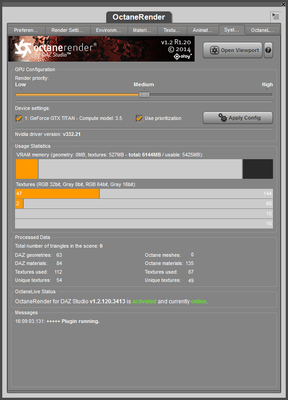

Random crash when switching from the TEXTURES tab to MATERIALS with scene loaded.
DAZStudio.exe caused ACCESS_VIOLATION in module "C:\Program Files\DAZ 3D\DAZStudio4.6\QtCore4.dll" at 0033:000000005B093816, QString::QString()+6 byte(s)
System status from scene causing the random crash
Win 8.1 Pro 64bit | GTX 660Ti, GTX TITAN, 6GB GDDR5 | Intel Core i7 3970x, 3.5 GHz | ASUS P9X79WS | 64GB RAM
t_3
Posts: 2871
vortex3d wrote:Random crash when switching from the TEXTURES tab to MATERIALS with scene loaded.
the update i'm about to post is going to sort these random crashes out. the single reason for them all is my attempt to handle material and texture processing in different threads/multithreaded. up until this next update i wanted to test if it may work out or not - apparently it doesn't. the main problem in achieving this is that the daz api is not "thread safe" and there is no real way to make it such, but change it (hello daz ;)); apart from that the more tasks the plugin needs to accomplish (like now also managing all maps in studio and octane), the more likely this leads to problems, also depending on the overall system performance.
to put it short: mat and texture processing is shifted back to work non multithreaded = no more crashes because of that...

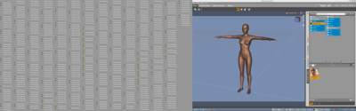

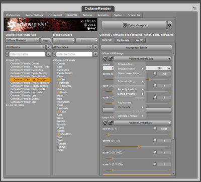

More duplication fun :)
Basic "Genesis 2 Female" objects appear multiple times when using Quick Edit to select an image map by object.
t_3
Posts: 2871
vortex3d wrote:More duplication fun :)
one time for each map ;) this is sorted out - 'am currently typing the post...

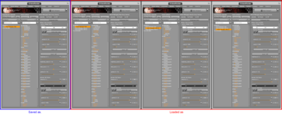

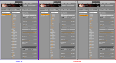

Attack of the clones!
Shared materials split randomly on load and saving at this point will make matters worse.
I don't know what triggers this behavior, but I can't duplicate it with single items or basic scenes.
FYI: This test scene was stripped of previous Octane data using the plugin's function. Could that add to the problem?
Loaded immediately after saving and performing a CTRL-N to clear the scene.
Clear & reload of the same file.
