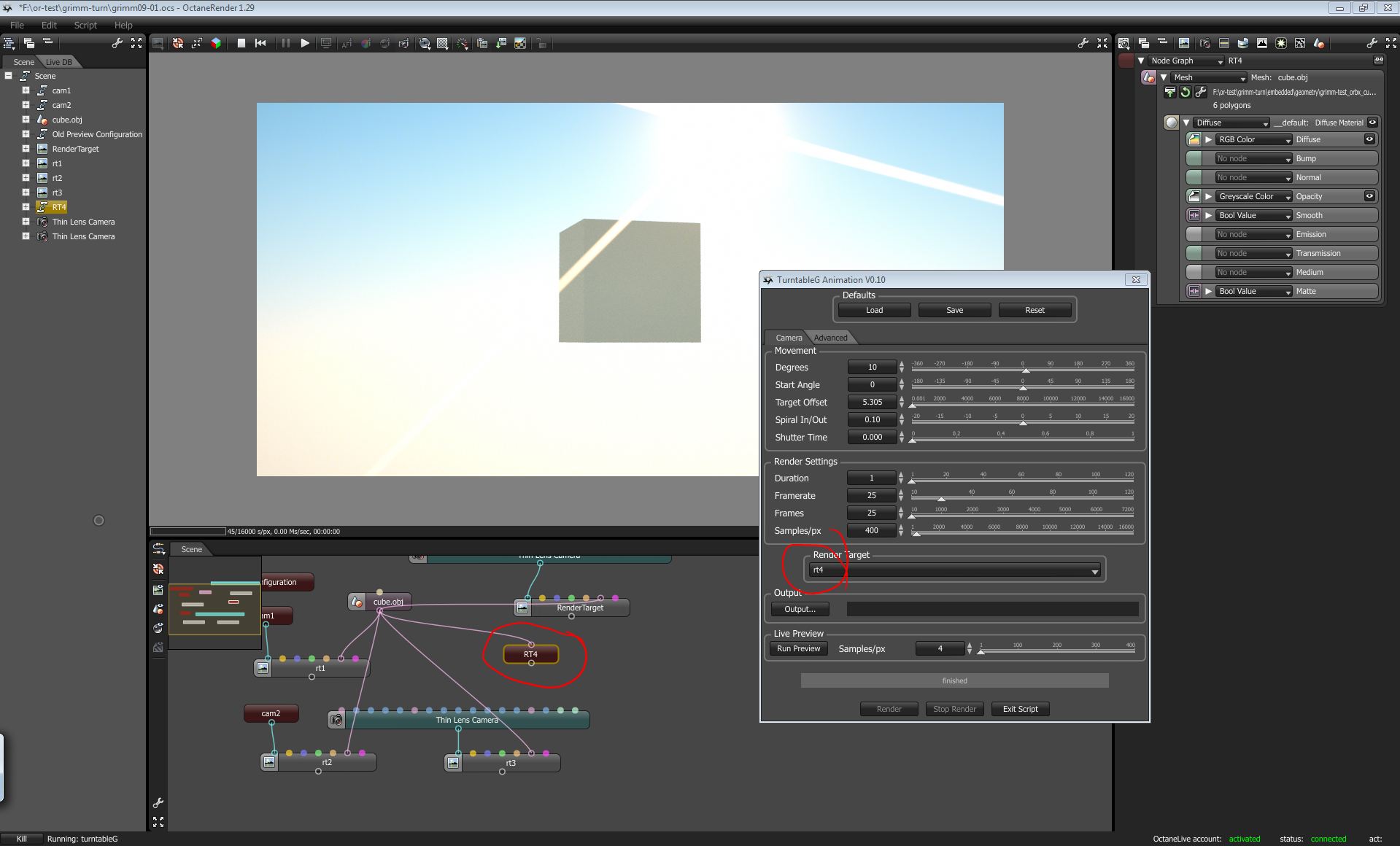

hi grimm,
big thanks for the update, finally it works as expected alsp with nested rt :)
little note: on mac all is perfect, on win if you select the rt4 the script start but the rt1 is selected, absolutly not a big issue ;)

bepeg4d wrote: little note: on mac all is perfect, on win if you select the rt4 the script start but the rt1 is selected, absolutly not a big issue ;)
Yes, your milage may vary on this. I don't have any control of the order in which the render targets will be found. You will probably see the same problem with the mac as well. Also you might want to make sure you name your groups and the render targets nodes differently. It may be that some of the problems you are having is because they have the same name?

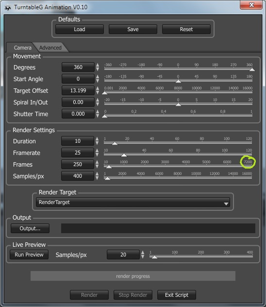

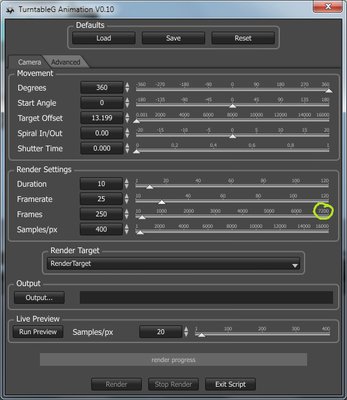

small slider mistake - should be 14400

grimm
Posts: 1332
Joined: Wed Jan 27, 2010 8:11 pm
Location: Spokane, Washington, USA
New version on the first post... :)
