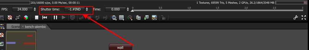

Octane crashed on me when I tried to maximize the image panel. All I had done was to load Ray Tracy's Alembic file, set the shutter time to 0.05, and clicked on the render target node.
When I maximize before loading the file it works fine and I can maximize all the other panels, just the image panel causes the crash.
Here is the error:
I'm also getting a whole bunch of these errors:
Here is the error:

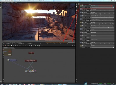

It's kinda getting crowded in the node inspector now. Anyway to save to .osc file which node you have set to collapsed or not? That would really help a lot IMO.
