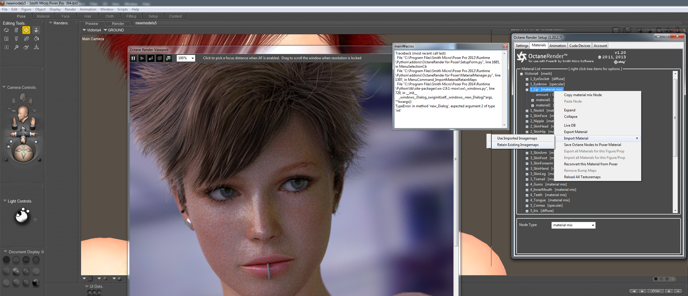

I been playing around with SSS skin types
But I'm getting an error message when trying to import material types. Into octane render SEE below picture.
This seems that only happen on certain node types from what I can understand?
This only seems to happen when selecting retain Existing image maps
It is trying to popup an error saying that the destination material has more then one diffuse, bump or opacity map (and therefor it doesn't know which one to keep). I will fix the error in the next version.

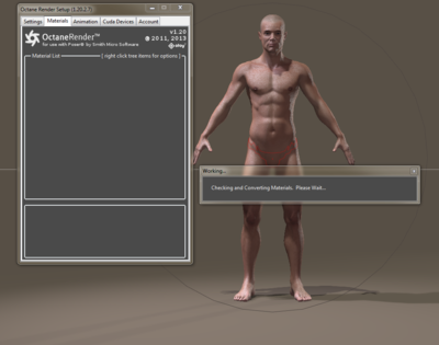

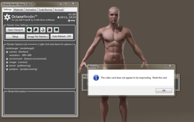

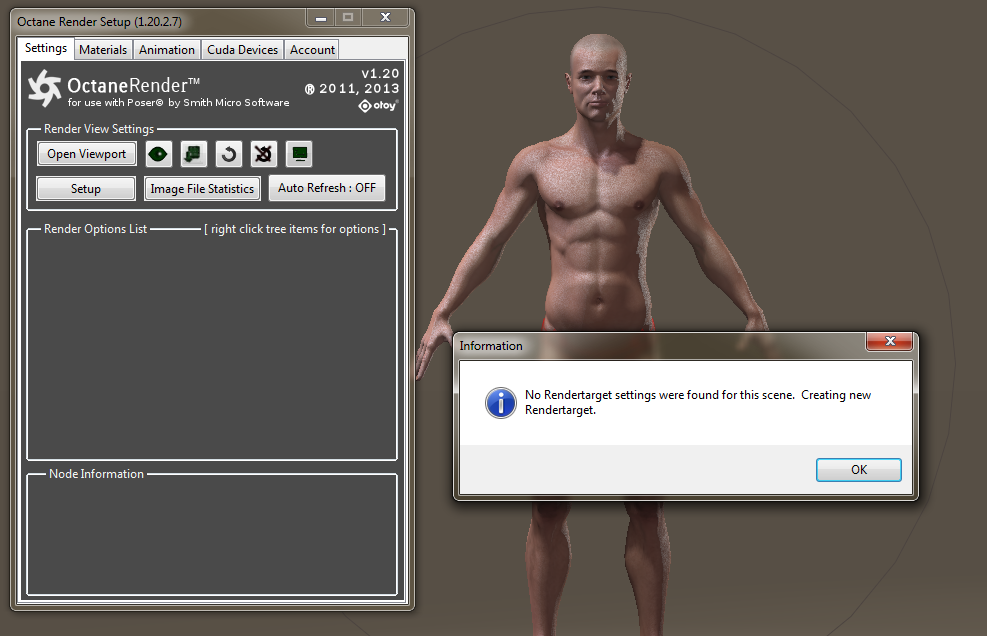

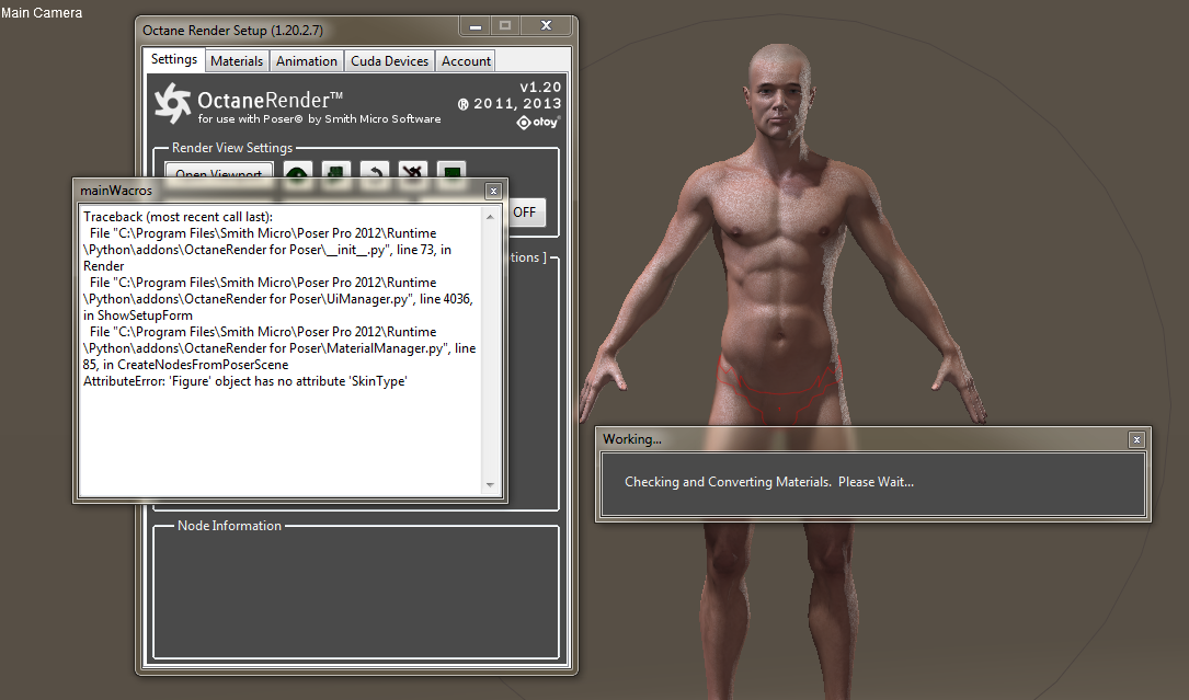

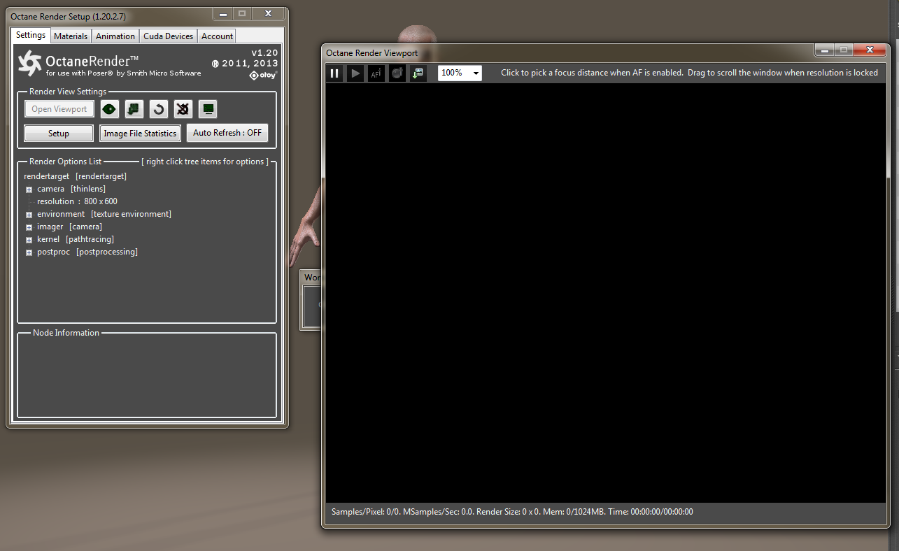

Here is my errors..
Close 'no render target error, brings up 'main wacros error' and 'checking & converting materials please wait (never goes).. Close 'main wacros error' and choose octane render from file/render menu and get black screen, then 'This video card is not responding check the card' error pops up!
Strangely, I can use Standalone, OcDs & Blender integrated version with NO issues!
Any ideas please?, Thanks :D
The reason for this error is that you are on Poser Pro 2012, but have installed the latest SR - which means the plugin is expected a PoserPython function call that is only available in Poser Pro 2014. I will fix this in the Octane 1.23 test build - which will hopefully be available today. The only work-around until then is to uninstall that 2012 SR, or use PP2014.
