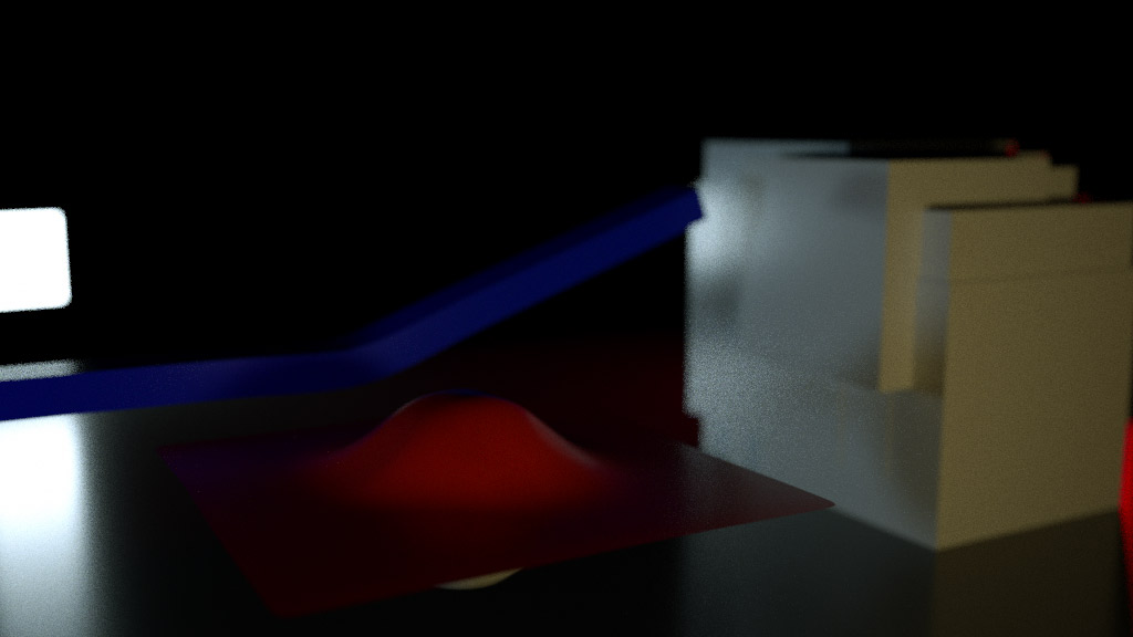

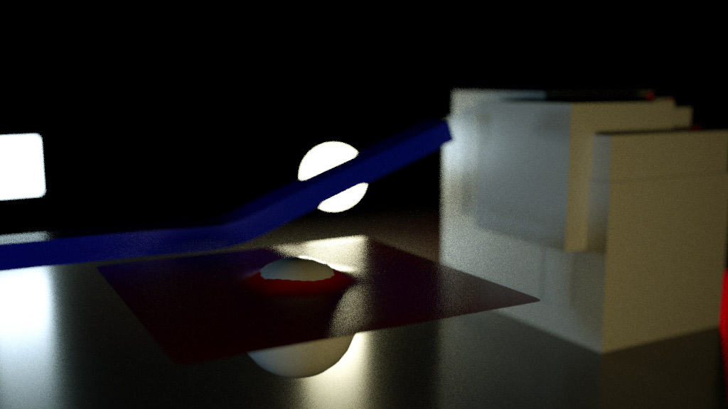

I had some time to test your update geometry scene with 0.6.8a and found a problem with the picture manager renderer not showing up some geometry as I experienced in some of my scenes. In this case the sphere with the lightemission texture is missing completely, but showing up in openGL preview and Octane Live Viewer.
See pictures above for finale Renderings (1st with preview renderer, 2nd with picture manager renderer): But you can also see, that the Picture Manager rendering is more accurate in case of the cloth collision tag with the sphere.
