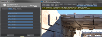

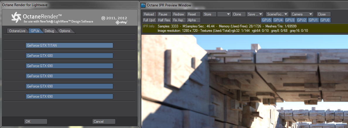

BorisGoreta
Posts: 1424
Joined: Fri Dec 07, 2012 6:45 pm
I am sorry, here is the information about the benchmark so you can compare card speeds:
Total 46.44
Here are results per GPU:
TITAN 13.38
GTX 680 6.5
GTX 690 12.94
GTX 690 13.08
Two gtx690 are slightly different, I don't know why, one is Asus and one is Gainward, maybe they are clocked slightly different. But TITAN is fastest in Octane, I thought TITAN would be 85% the speed of GTX 690 but no, TITAN is the king. I'm using 314.14 drivers.
