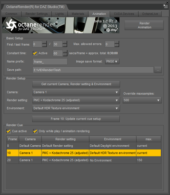

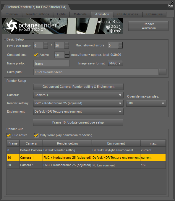

animation rendering is straight forward. the plugin recalls the timeline frame by frame and renders out whatever there is. this works with bvh and aniMate2; keyMate needs to be yet tested. in addition a simple animation cue is included, which allows to switch cameras, render settings and environments. the idea is to automate rendering non-animated sequences, which might require some different settings; switching cameras could be helpful for animation rendering too. fully animatable octane parameters (lights, materials, etc.) is on the todo list, and will be part of a later update.rcallicotte wrote:@t_3, this looks great. What, if any, animation controls or animation tools will be in place to move animated or BVH scenes into this new package?
the animation dialog of the plugin: a note about voxelizing: since this can be done multi-threaded (object based), the voxelizing time inbetween frames can get pretty low. in addition the modifier state is generally cached, thus only objects which geometries did actually change are voxelized anew. pos/rot/scale transformations can be done by using octane's placement nodes, means such simple changes won't need voxelizing at all. and of course otoy is still working to make voxelizing even faster
