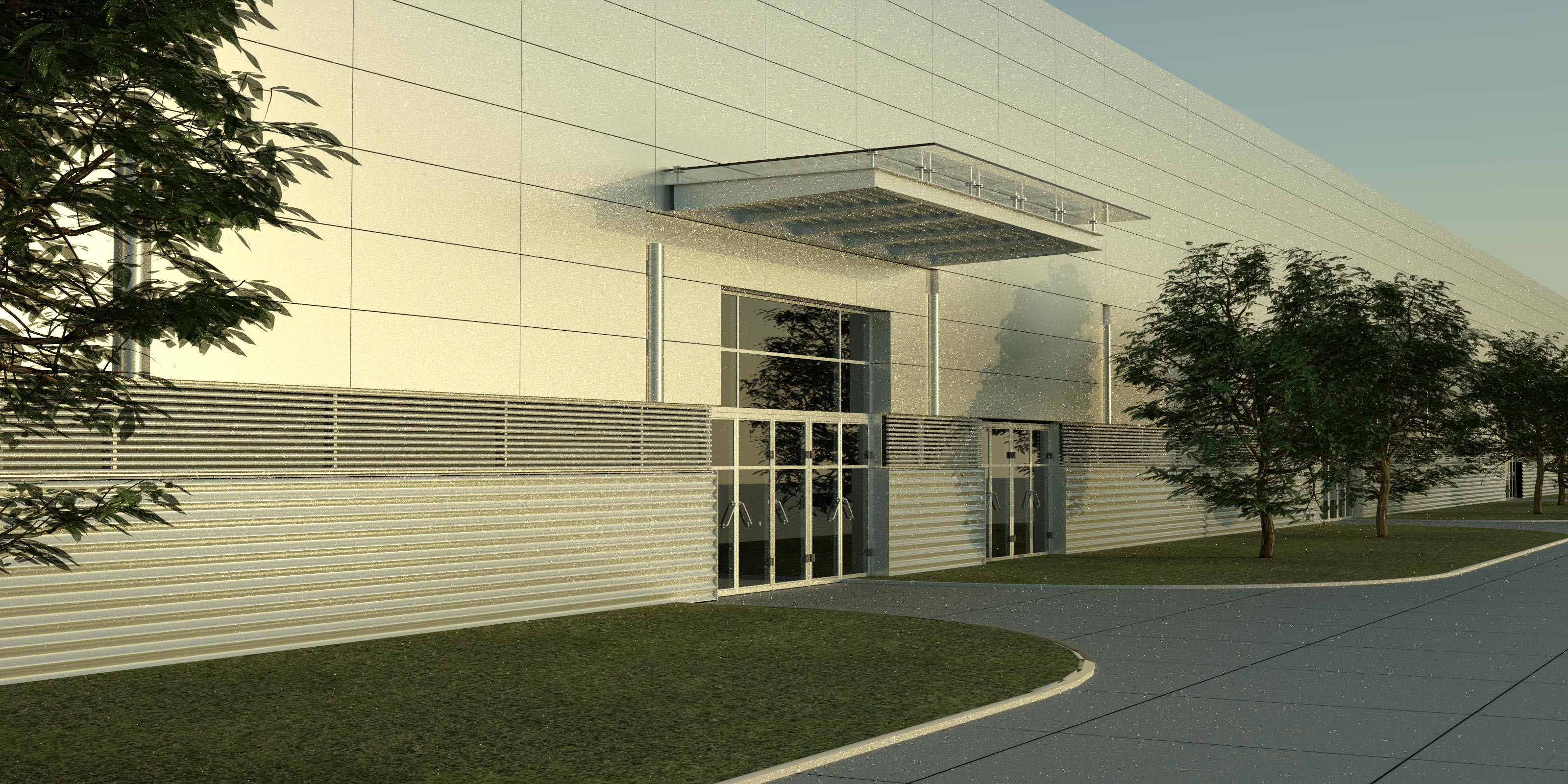

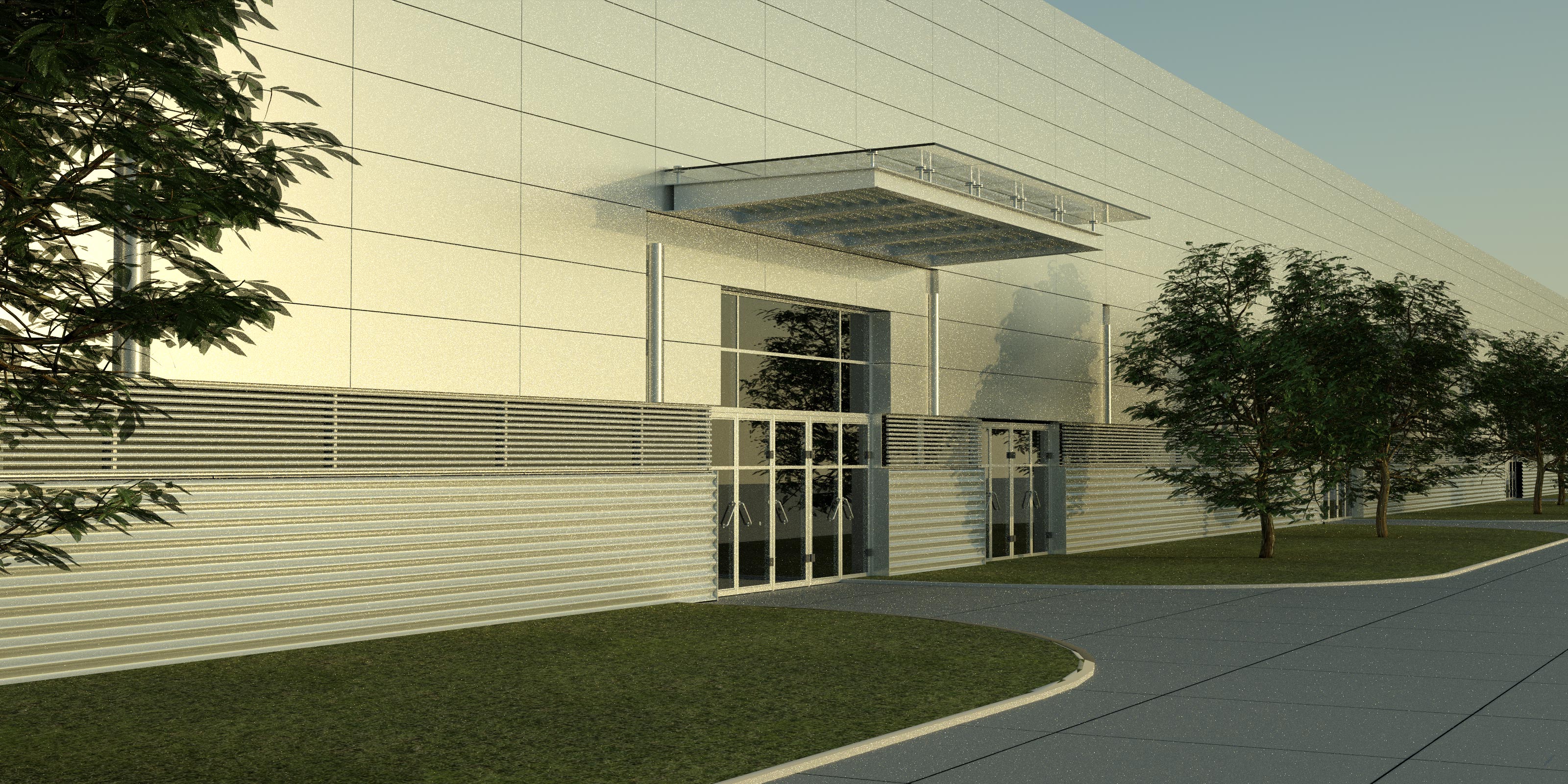

I noticed some strange thing in quality od rendered picture (RC3).
I made 2 tries - first for 32 minutes of rendering and next one for 93 minutes rendering.
The differences in quality (noise) are almost INVISIBLE. There are almost the same count of hotpixels (strongly visible) i see only little differences on glass doors and little less noise (reaaaaaallly little less) on other parts of rendered pictures.
And some parts of model are still unfinished (looks like blurred). i had a depth of field turned OFF. Aperture almost 0.
Resolution - 3200x1600.
Triangles - 1103960 (rather biiig scene).
Rendering Mode - pathtracing with 2x2 subsampling.
is it OK - i thought that 3x times more rendering should definitly change a quality of noise.
Is it problem with glossy material? (most part of model are texture by GLOSSY metal, and these parts are noisy the same after 32 or 93 minutes. hotpixels are still to much visible -after 32 minutes and after 93 minutes of rendering).
Is any chance to get better quality in next release? especially in glass (too many hot pixels) and glossy metals.
