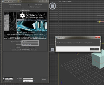

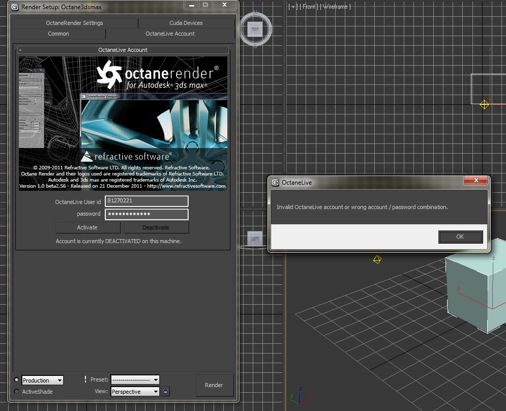

Hi..the same for me.. I'm a customer. I have Octane Render..so I have activated my plugin with my customer user and password..
I would like try Octane for 3Dmax but with the same User and password..dont'work. While I'have activated account on my PC in Octane Render and I can use it with C4D perfectly.. Thanks
