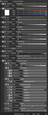

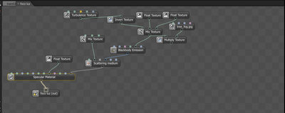

@gilfanovruslan, most procedurals generators in Octane are 3D, just use a 3D float in the scale and you'll see it at work, also if you download my scene you'll see that the fog was done with a box on top of the objects that I wanted to add fog to. The only thing is that it doesn't work from inside... but I'm sure will figure something out.

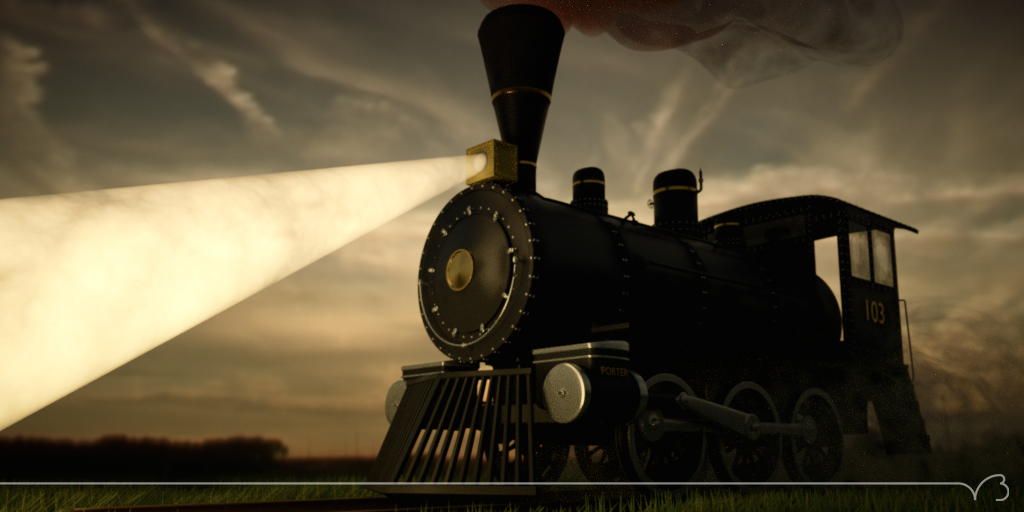

a little update on the fog, this time I tried to do a volumetric ray aka god ray for the train scene, it's almost right, so it might be achieved playing a little more with the texture... I'm planning on using it doing an interior scene, that with some luck I'll get in the contest in time, I'll update my tests about it.
Also about general fog, or enviroment fog, I've created a nice effect using a dome with normals to the inside and the same material than in the first test to create a distance/enviroment/low clouds effect like placing between my main focus in the center and the objets in the "horizont" as mountains, and then having the camera inside creates a nice depth sensation. I'll post some test on that approach as the scene develops.

Is there a way to add a ramp node that makes the fog effect trail off in "length" and width.
I tried in with a simple ramp JPG texture on a cone....and it worked pretty good "length" wise on the light but nit so good on he edges.
You seem to have a great grasp of using nodes to mix and match needed results... is there a "ramp" node that somehow with opacity can combine your fog in a trailing off fashion?

that's a nice idea, I'll give it a shot cause right now I'm trying to achieve the volumetric light effect, as you did I've tried with a gradient jpg, but it's not quite there yet.

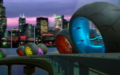

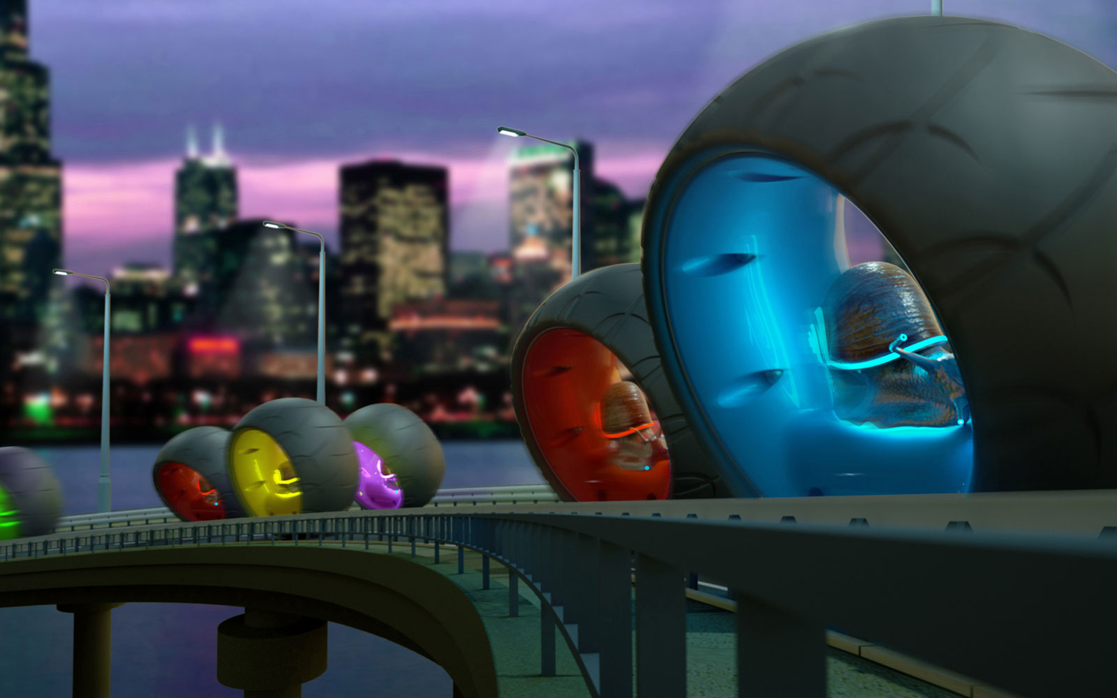

Cool Kubo. I just finished this one and had to add the small light fog coming off the lamps in post. I tried adding a cone and a volumetric but the sharp edges did not work. I am not as good as you with all the nodes.... so if you get it I will buy you a virtual coffee somewhere somehow : >)

those snails look really cool, I'll try to make some test this weekend, I'm sure that with the combined effort will finally get nice volumetric light!
