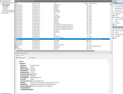

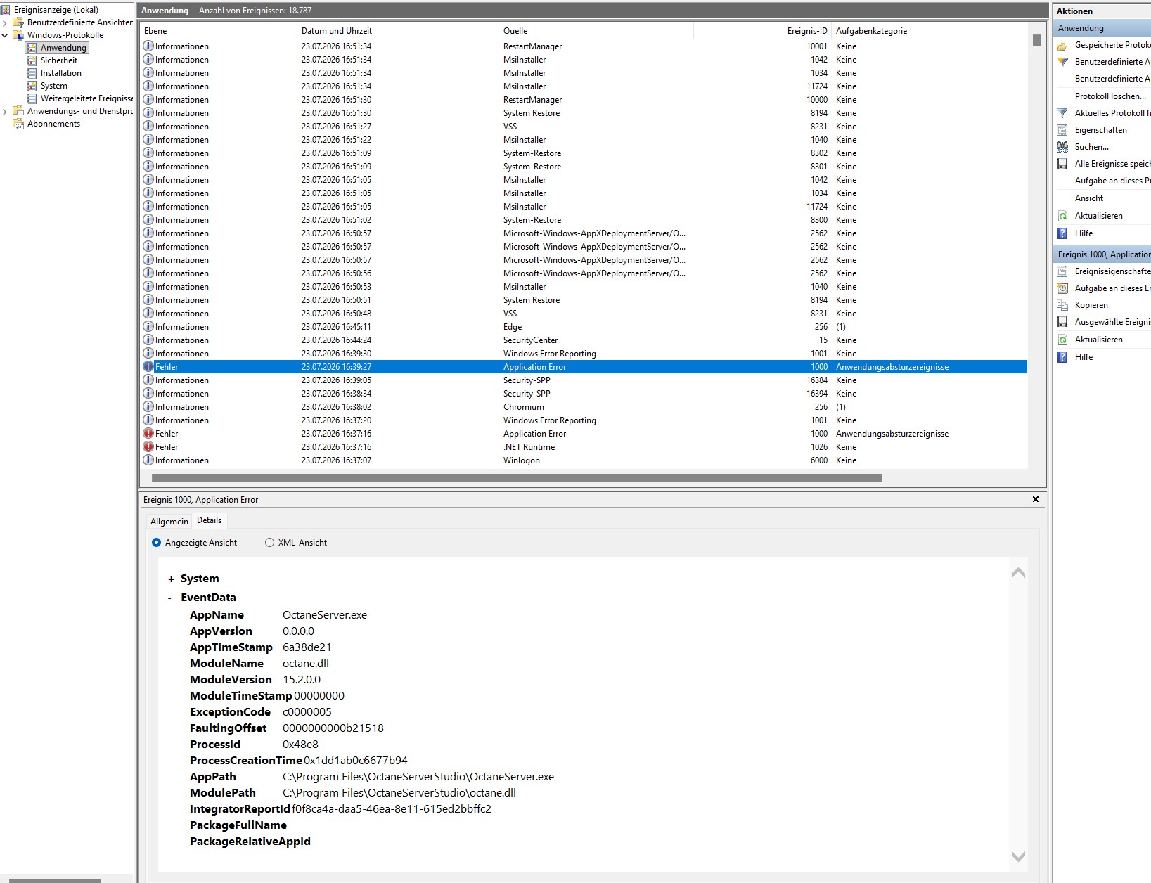

Hi Lino,
heres the detail tab:

This part of the Blender crash log only lists the loaded modules, so unfortunately it does not identify the cause of the Blender crash.
At the moment, the clearest information is that Octane Server is crashing inside octane.dll with an access violation.
