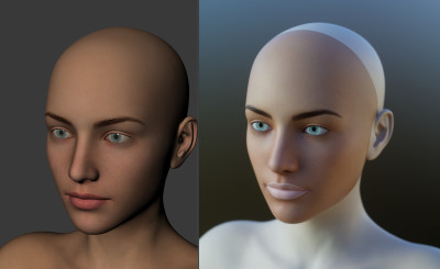

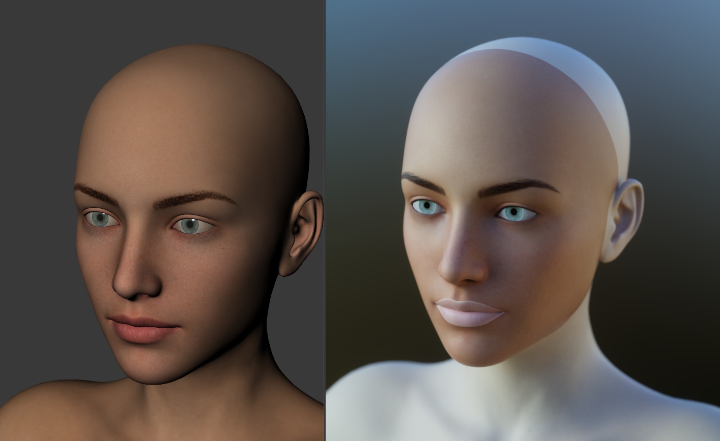

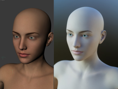

With this release, textures render very pale. (See attached)
With the previous release, everything was fine.

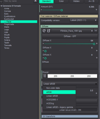

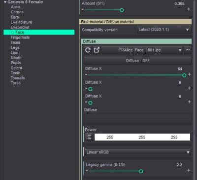

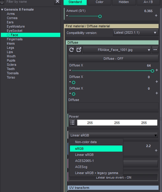

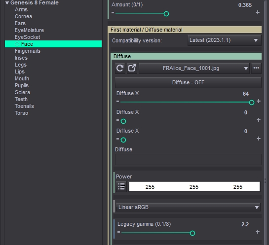

I discovered that a setting under 'Materials' - 'Diffuse' - 'Power' was set to 'Linear sRGB' (See attached)

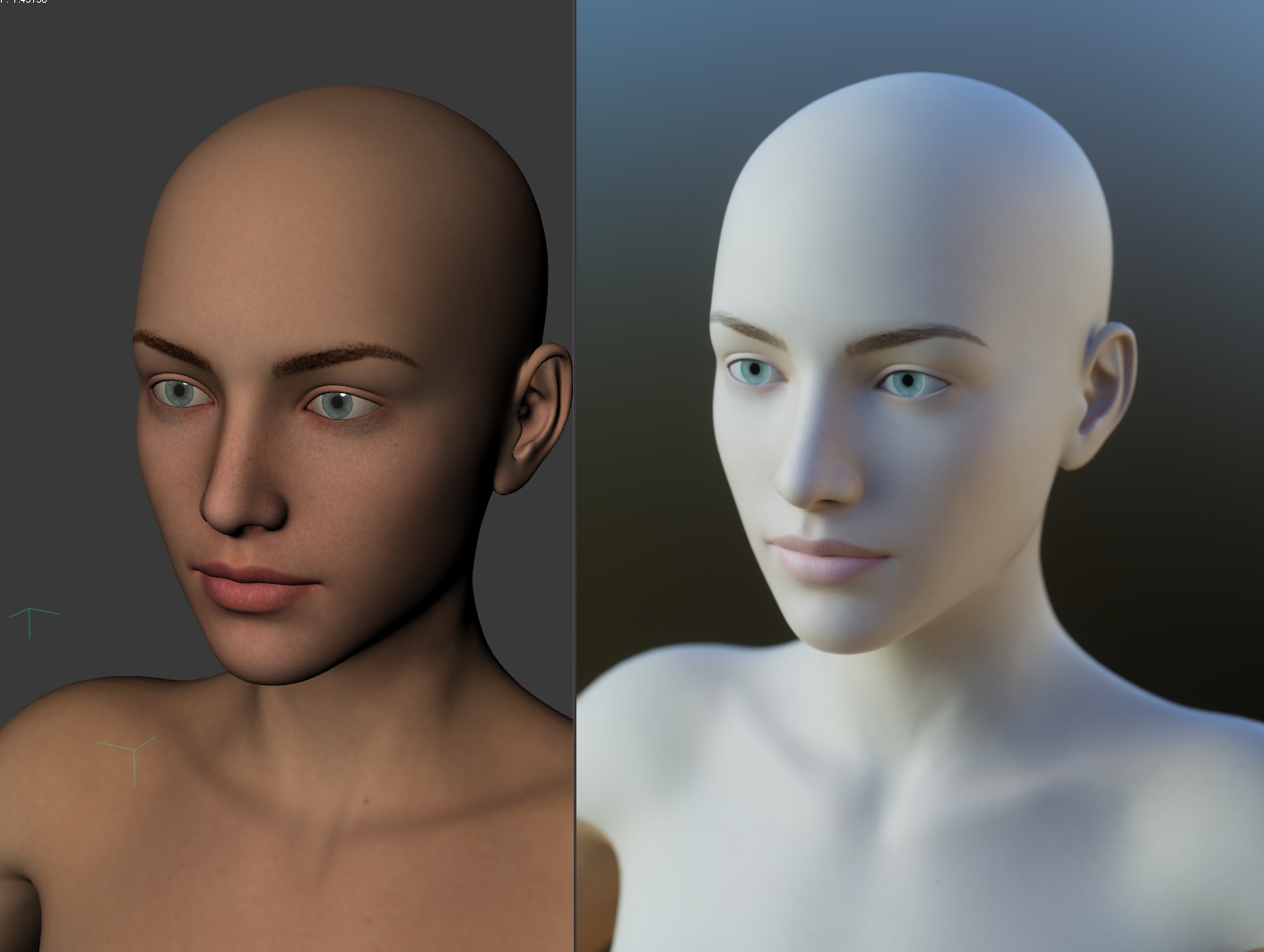

I changed it to sRGB (see attached)
The material rendered correctly in the Render Viewport. (See attached)
How do I set "sRGB" as the default, since it becomes tedious to change for every material in the scene?
Thanks for any help.

Hi RGUS ,
Thank you so much for this..
Yeah it looks washed out and pale.
We have made request ticket to change it to `sRGB` and Gamma as `1` by default for the next release.
cheers
Kind Regards
bk3d

BK wrote: Thu Jul 16, 2026 9:11 pm
RGUS wrote: Thu Jul 16, 2026 8:40 pm With this release, textures render very pale. (See attached)
Hi RGUS ,
cheers
That would be great, though the default value for Gamma in the Diffuse setting was always 2.2
Maybe I might be thinking about something else.
Thanks.

Hi RGUS ,
Thank you so much.Yes, 2.2 is old setting
We want to match the node parameters to Octane Standalone.
Cheers

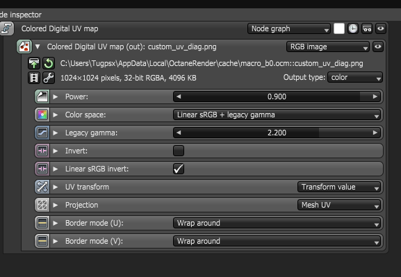

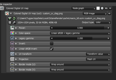

Actually the default Color Space for the standalone is Linear sRGB + legacy gamma.
Open any old material from the LivedB and you will see the setting.
If you look at the iRay settings under Spectral Conversion Color Space, you will notice that it is set to Rec 709/Linear sRGB.
