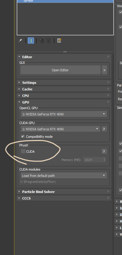

There is still a bug with TyFlow that causes very slow evaluation times. When we have more than 30,000 fractured pieces (for example, a breaking wood simulation), the evaluation time is 1–2 minutes per frame. I'm not sure why, since everything in TyFlow is cached and the fractured pieces are only changing their positions.
UPDATE:
There appears to be a conflict between calculating TyFlow particles on the GPU (CUDA) and rendering on the same GPUs. I suspect the GPUs get clogged, and the VRAM isn't fully released, even when the memory limit is set to 1024 MB and the GPU is not being used for rendering. It is only being used as the display card. After restarting 3ds Max and resimulating using CPU evaluation, the evaluation times became much faster.

UPDATE:
UPDATE 2:
The evaluation times gradually get slower as more wooden chunks are created. I think there is an issue with evaluation performance when handling a large number of unique fractured chunks compared to TyFlow using a single instanced mesh.
