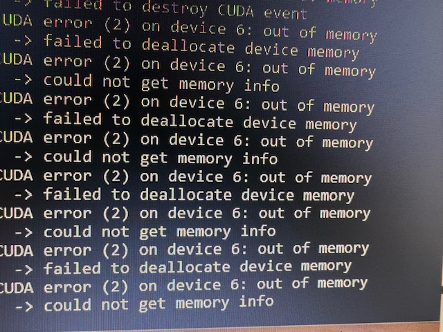

This problem hasn’t been resolved for years:
VRAM / CPU RAM issue
When VRAM is fully utilized and the system starts using CPU RAM, the slave machines always crash. They never render and consistently report “not enough VRAM.” Why don’t they use CPU RAM the same way the master GPUs do?
We have out-of-core rendering enabled with 16 GB per slave. The master machine, with 3 GPUs, renders correctly using CPU RAM.

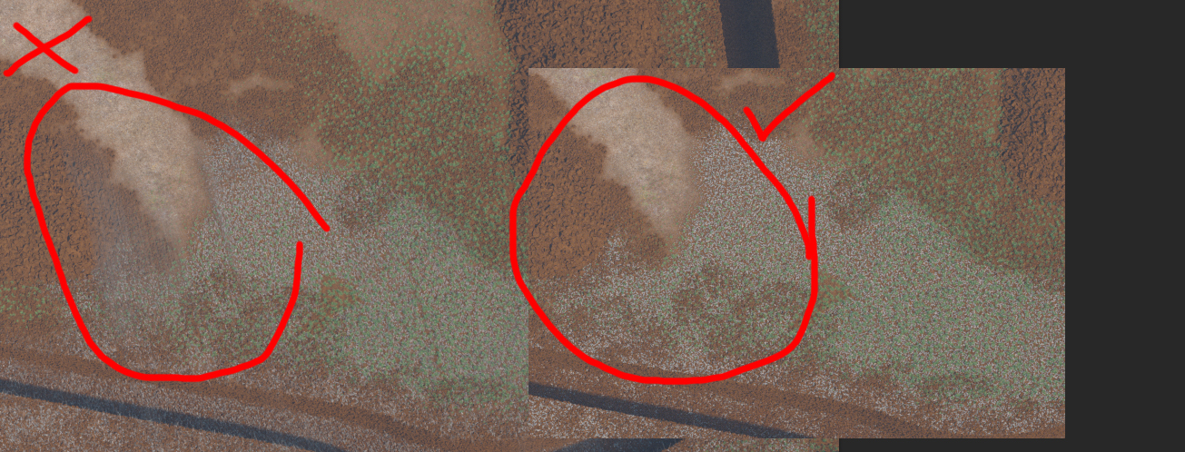

1. Slow rendering when iToo is present
There is still a bug related to iToo. If an iToo reference mesh has motion blur enabled (accidentally) and a camera is animated, stationary iToo objects appear as if they are moving at high speed. (image attached)
