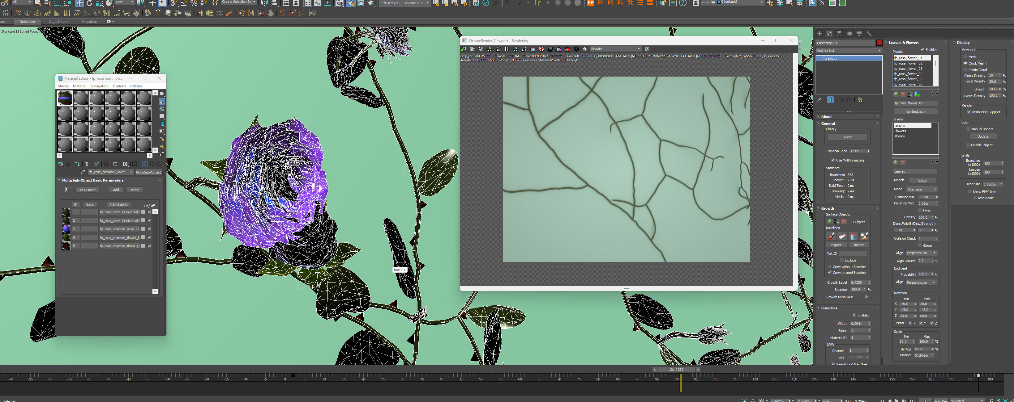

For some reason when using a quick mesh and point cloud with octane we cannot render flowers and leaves. Is it a bug? (We are using itoo 9 Forest IVY)

Yes you can only render full geometry for ForestIvy. I had a project with a huge wall and had to switch back to a common 3D model.

this is from itoo people. Can you please add support for forest ivy?coilbook wrote: Wed Sep 03, 2025 3:23 pm Hi,
"It appears that Octane Render is currently unable to process the ForestIvy structure. Therefore, the Mesh Viewport mode must be used to render the object accurately. I’m afraid that we can't do much more in this case. For developers of render engines that don't have an SDK (like the mentioned Octane), we provide an internal API written in C++ for the 3ds Max SDK. They use this data to generate the instances directly in their render engine, and the final implementation of ForestPack's features depends on the way it's done for that specific render engine."

Hi coilbook,coilbook wrote: Sun Sep 07, 2025 2:42 pmthis is from itoo people. Can you please add support for forest ivy?coilbook wrote: Wed Sep 03, 2025 3:23 pm Hi,
That's right, the ForestPack IVY objects are not natively supported in current versions.
We are adding support for the next versions (16.09 and 26.02)
