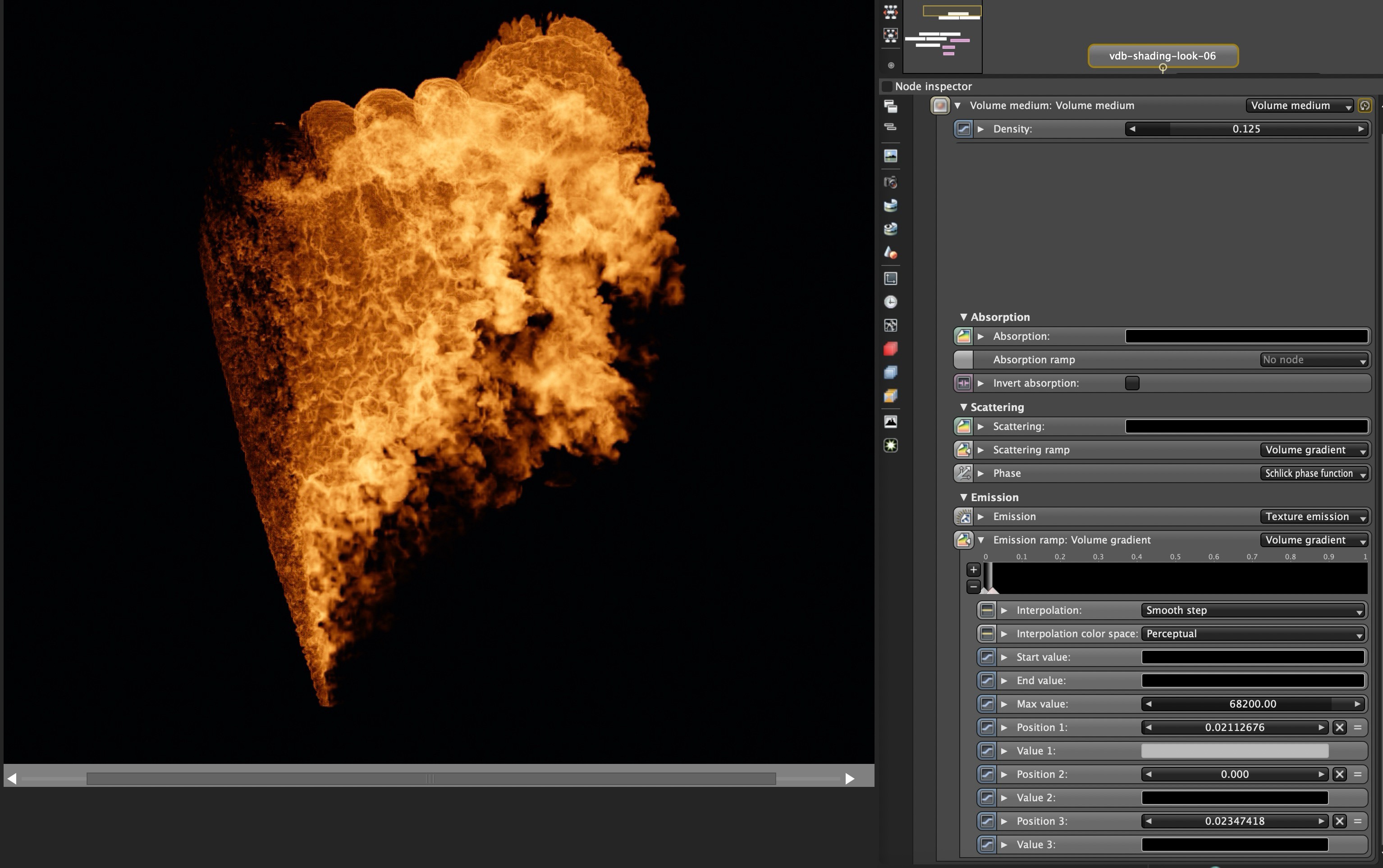

Jukyan wrote: Sat May 24, 2025 1:22 pm Allright,
thanks for the effort !
But these are all too smokey and not flamey , especially at the source...
This effect is important to get right
Like so?
Scattering has been disabled to focus solely on the "Flamey" part, it can be re-enabled and tweaked rather independently and quite simply.
Material group ORBX:

GIF (video)
of the "flamey" controls and live tweaking (to taste or reference):
