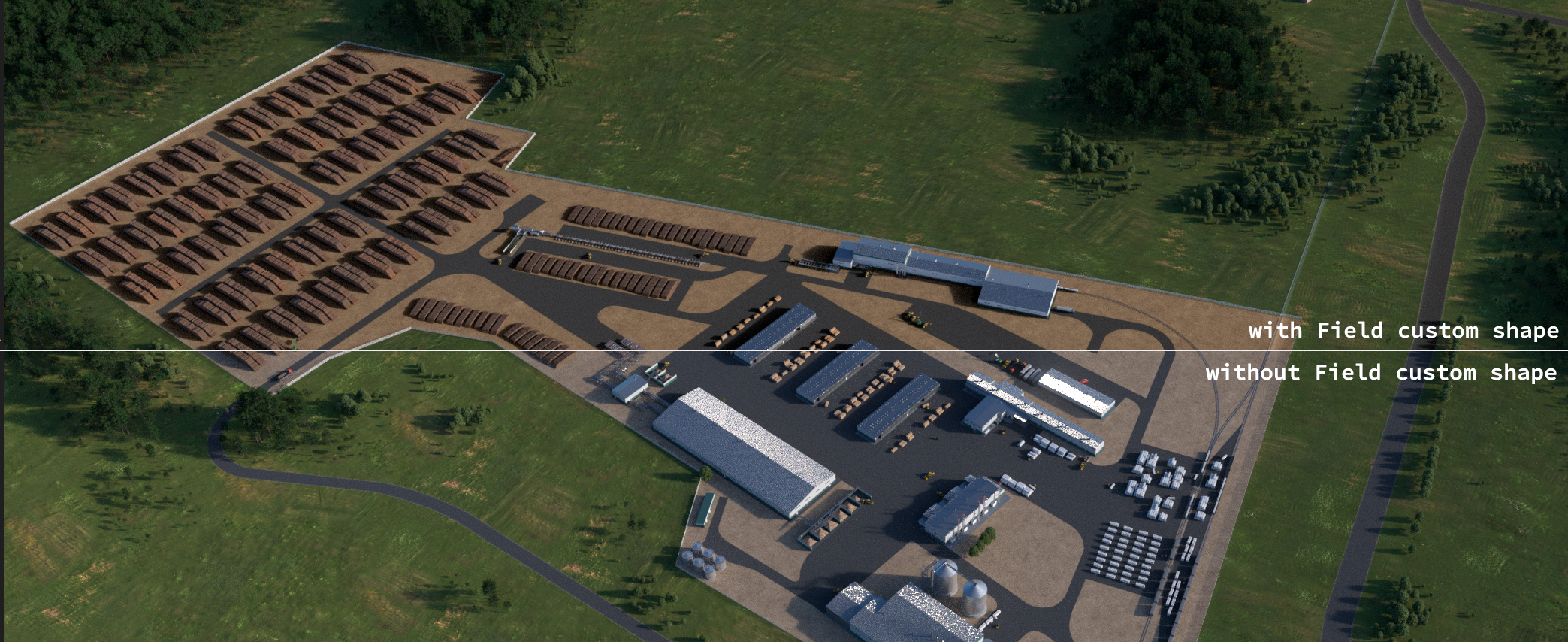

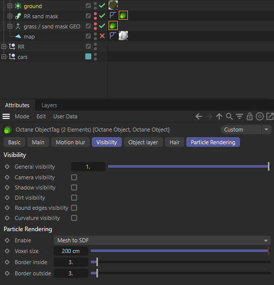

Hello!
Trying to utilize octane Field texture with custom shape for a masking purpose of mixing textures and get weird results.
Scene look changes dramatically. For custom shapes I turned off any visibility options but got huge influence over colors and shadows.
And render time increases a lot - from 50s without Fields custom shapes to 1m30s with Fields custom shapes
scene look versus
scene look versus
octane object tag options

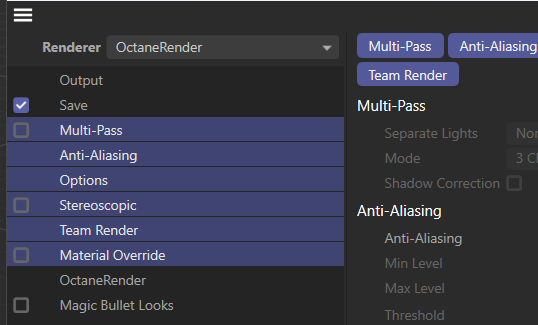

Hi, do we have a plan to clean up our render settings like https://developers.maxon.net/docs/cpp/2025_2_0a/classcinema_1_1_base_video_post.html#a610cf30456b13b5424797d73cfa63644?
I mean the standard videopost that Octane not ues.
that would be a lot easy to modify octane vp.
