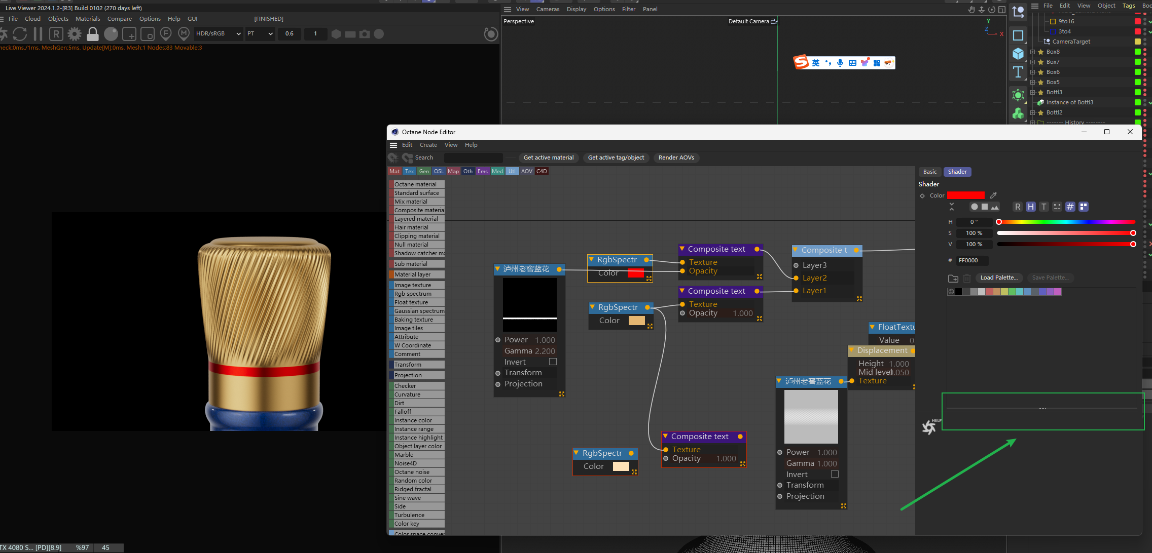

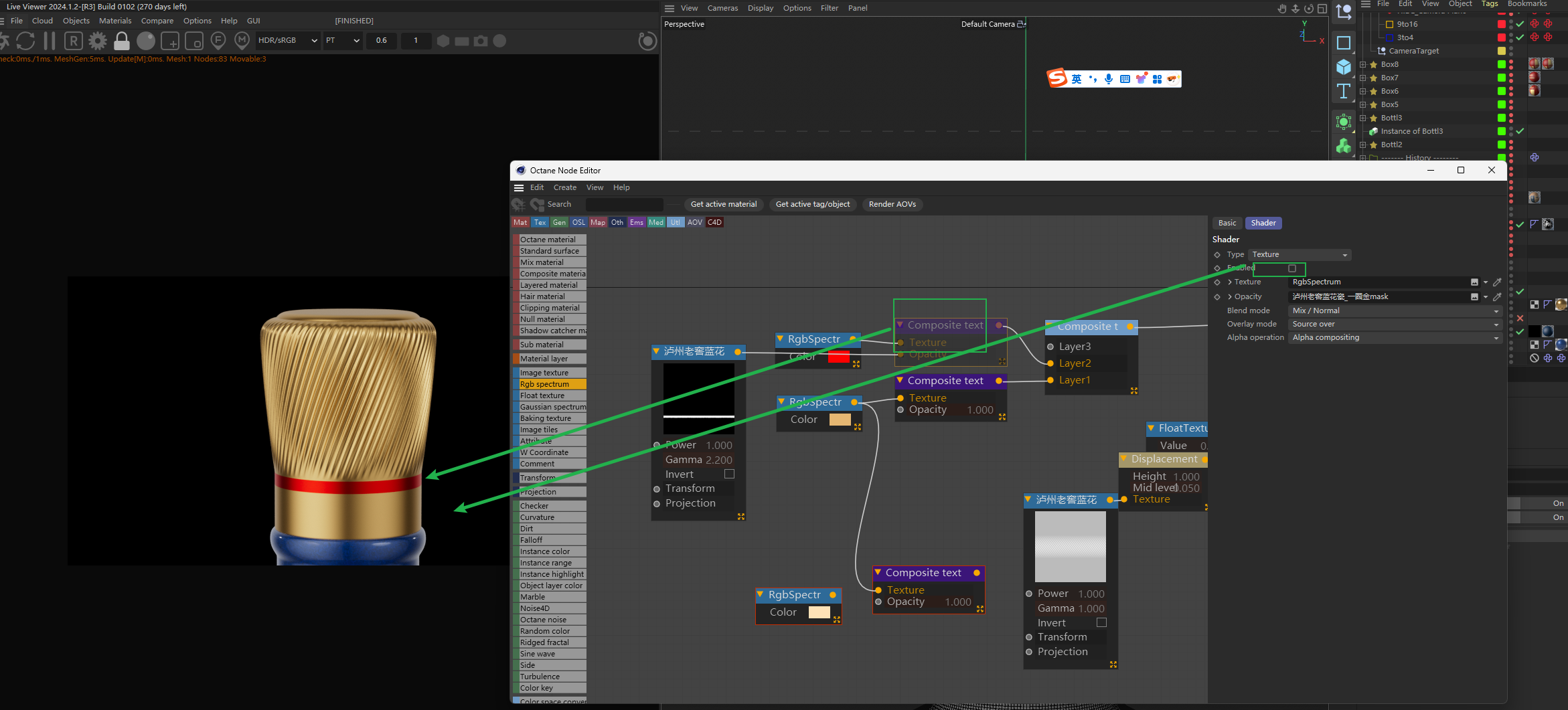

Two questions:
1.color the box below the drop-down line, click the other node and come back, this line will automatically recover! Figure 1
2.The "Enabled" of the "composite texture node "is invalid! Figure 2
Figure 2
Figure 2
Figure 1
Figure 1

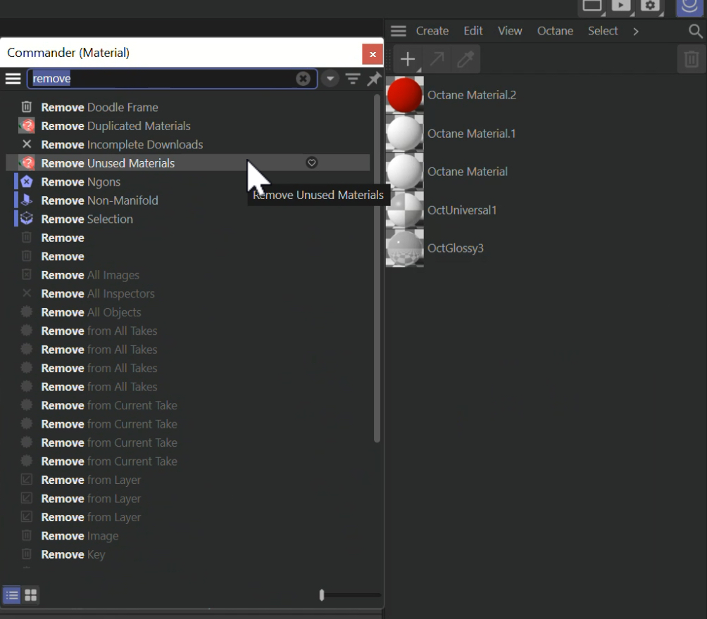

Hi, guys
Been some version now, prob since 2024, "Purge unused materials" is not really working.
Regards,

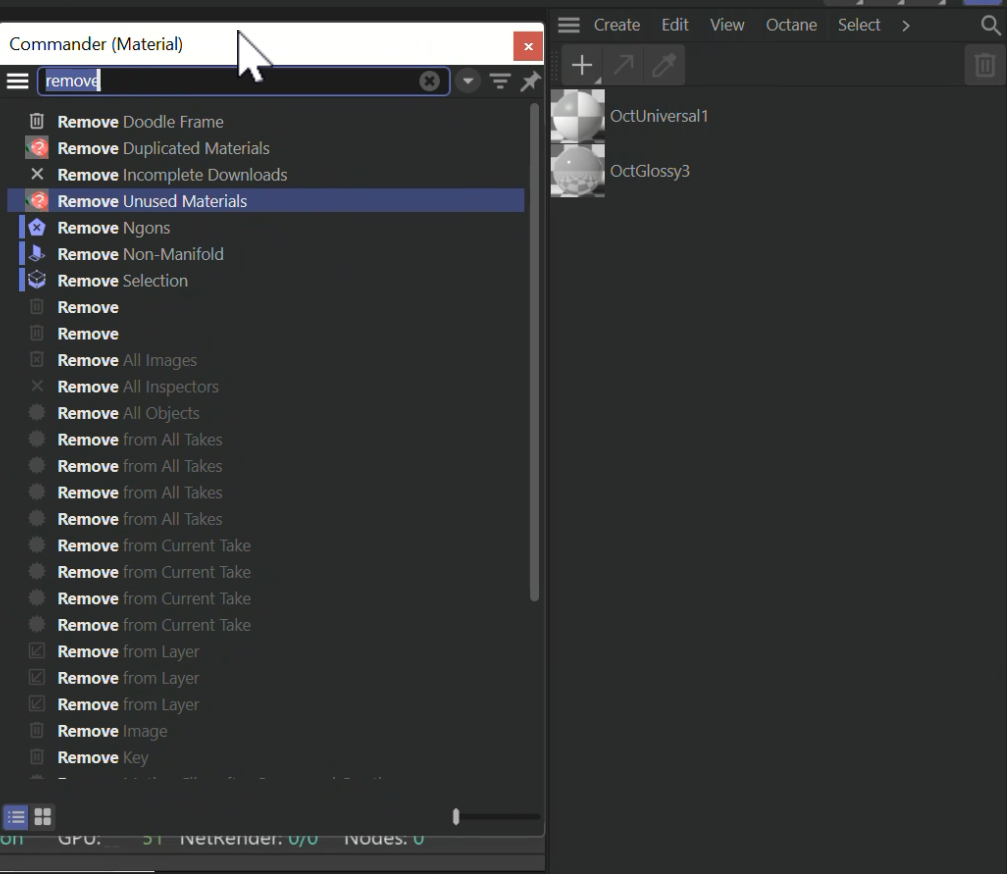

Posts: 10646
about "Remove unused materials" command, it works correctly with your scene.
Here is before:
And after:

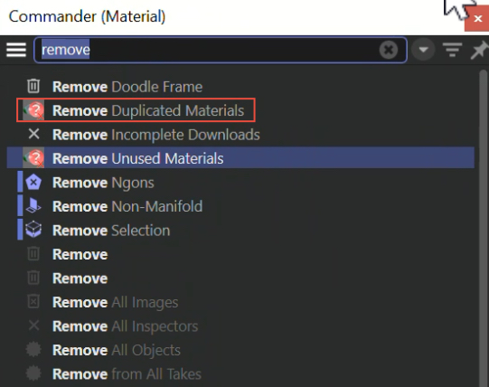

Are you sure to have not saved in your layout the "Remove duplicated materials" command?
It has the same icon but it is a different command.
ciao,
