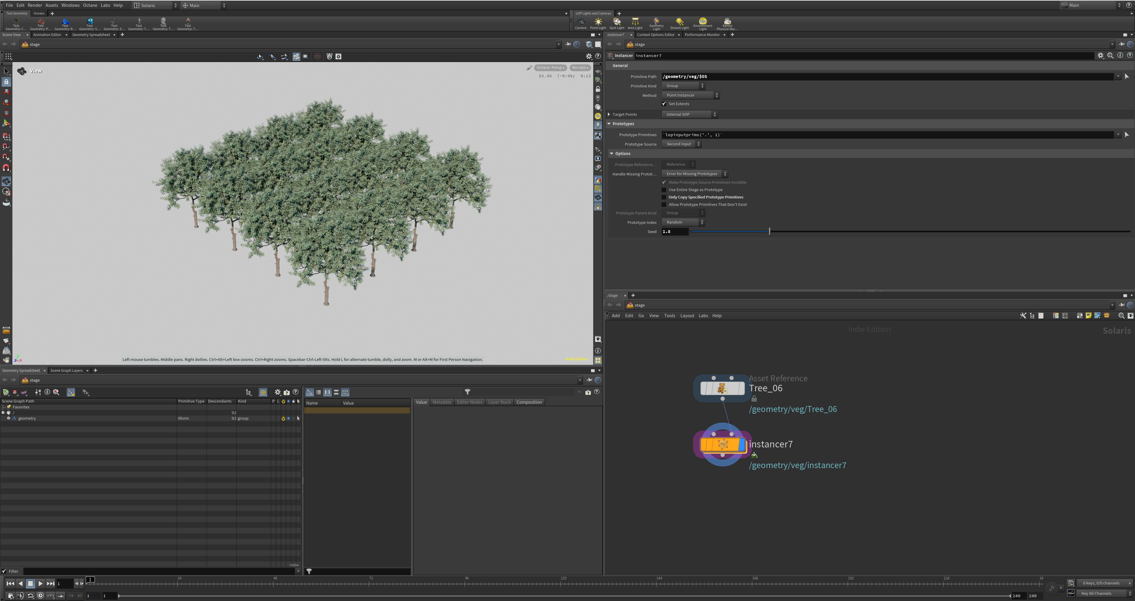

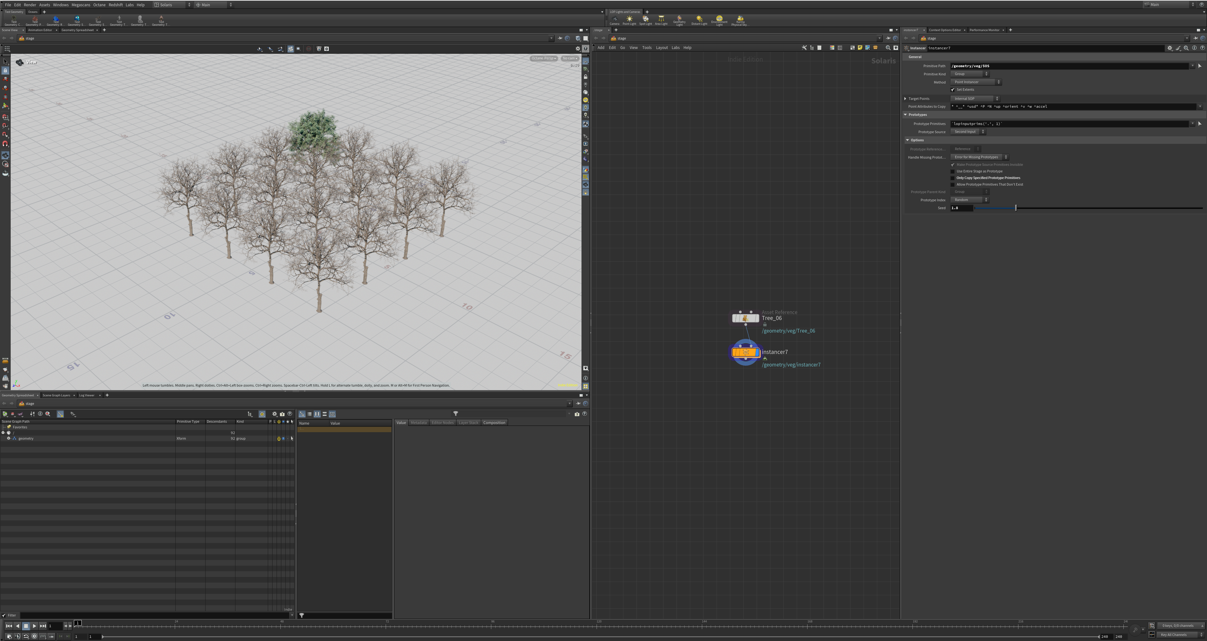

Nested instancing doesn't work properly in 20.5.xxx. Tree asset has instances leaves.
Here is a screenshot from 20.0.724 (2023.1.3.1|OctaneSolaris - RC11):
and here is a screenshot from 20.5.370 (2024.1.0.1|OctaneSolaris - R1):

Hi Galleon27,
Thank you so much for reporting this bug.
We have created an internal ticket. We hope to get this fixed asap!

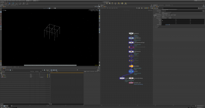

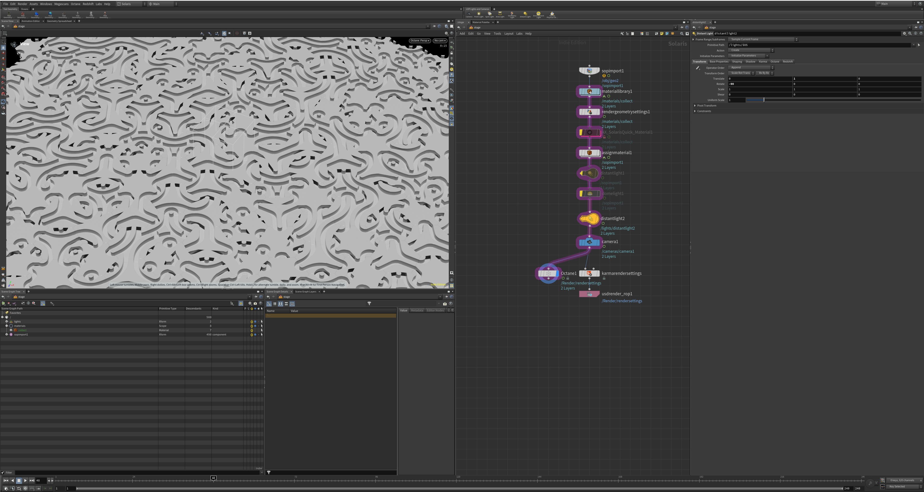

There is something wrong with the direction light. It goes dark at unexpected angles.
20.5.370
20.5.370
20.0.724
20.0.724
Win 10 64bit // GTX 4090 + GTX 3090 // 5900x // 64GB // SideFX Houdini // C4D
