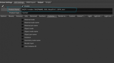

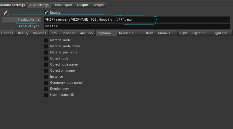

Can someone please explain to me what is the purpose of this?
What is the point in outputting the image twice? Once in the path set there and once in the path set in the output tab. Enabling and disabling doesn't do anything, it's always outputting twice.

galleon27 wrote:Can someone please explain to me what is the purpose of this?
Hey galleon2,
This feature is a workaround to allow us to render with Octane on its own in a single process quickly.
The $F requirement is for saving images in Houdini when rendering in a single process.
We can use Octane_raster as the Product Type to prevent Houdini from saving frames.
Please note, that when we use Octane_raster to prevent Houdini from saving frames, we still need $F in the file path in the Product name parameter.
The Octane AOVs won't appear in the viewport when using Octane_raster in the Octane node.
For now, we recommend using two Octane nodes to separate for viewport rendering raster and Octane_raster for the final render.
Cheers
connect the USD Render ROP node to the Octane node with Octane_raster to make it clear it is for final output.
Cheers
Kind Regards
