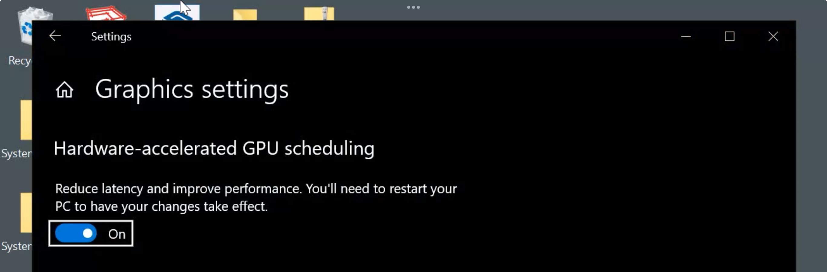

About new Nvidia driver 560.xx series, the first thing to check, especially in Win 10, is to have enabled HAGS in Windows Settigs/Graphics settings panel, in Win 11 should be enabled by default:
If yes, and you are still having stability issues, better to perform a clean installation of 552.22 Nvidia Studio driver:

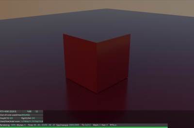

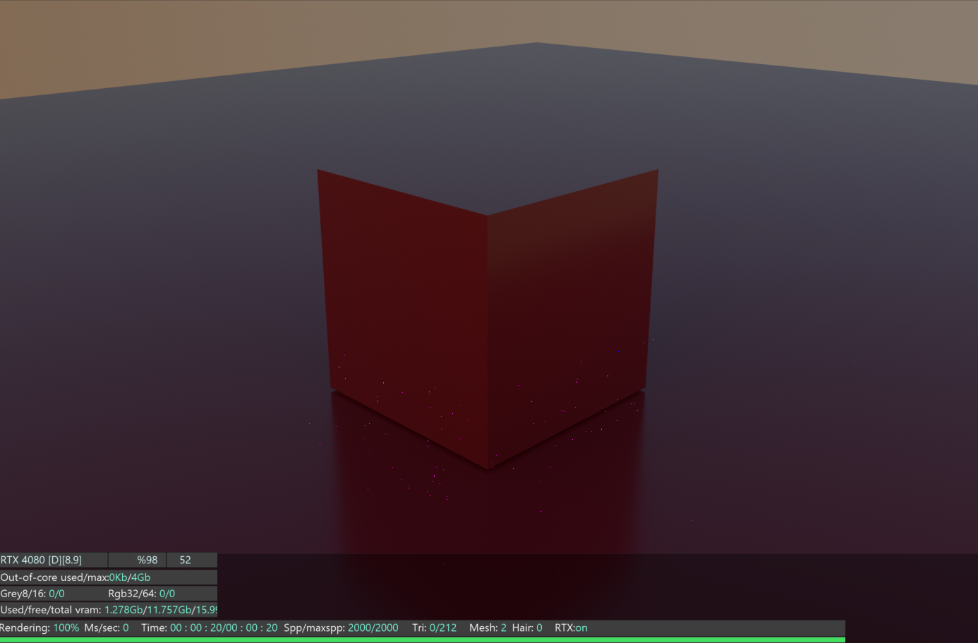

my admin installed 566.14 Studio Driver. I have a strange issue if RTX is on. See Screenshots.
RTX OFF

RTX ON
Is this a driver issue?
Posts: 10661
Weird, you are the first one reporting this!
Which exact version of c4doctane plugin are you using?

It´s 2024.1 R3 with a Lenovo 4080. (Intel UHD Graphics 770 still active)
Posts: 10661
Ok, please write to help at otoy dot com asking for Beppe!
