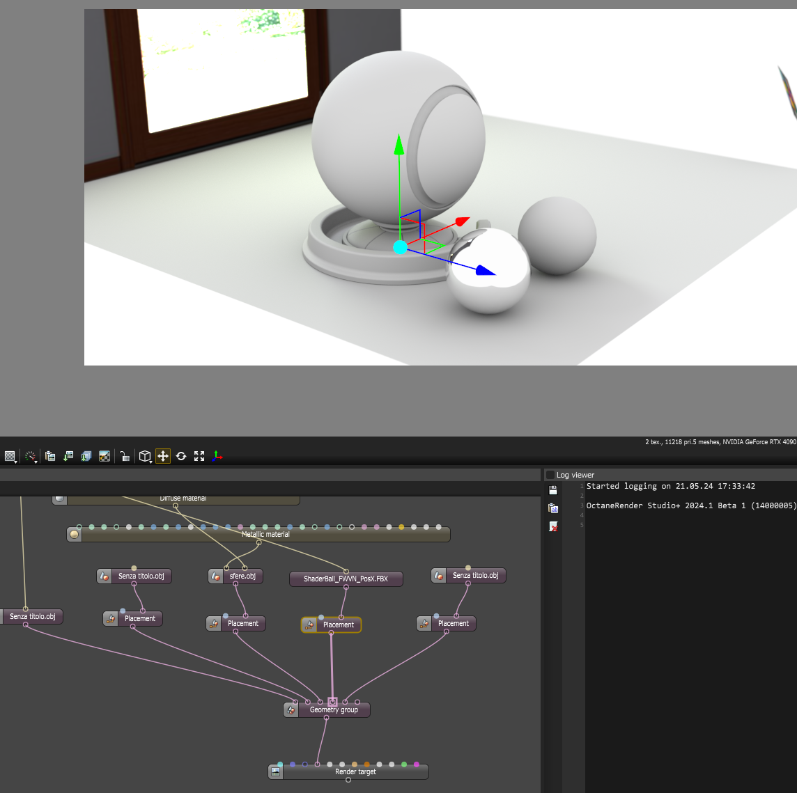

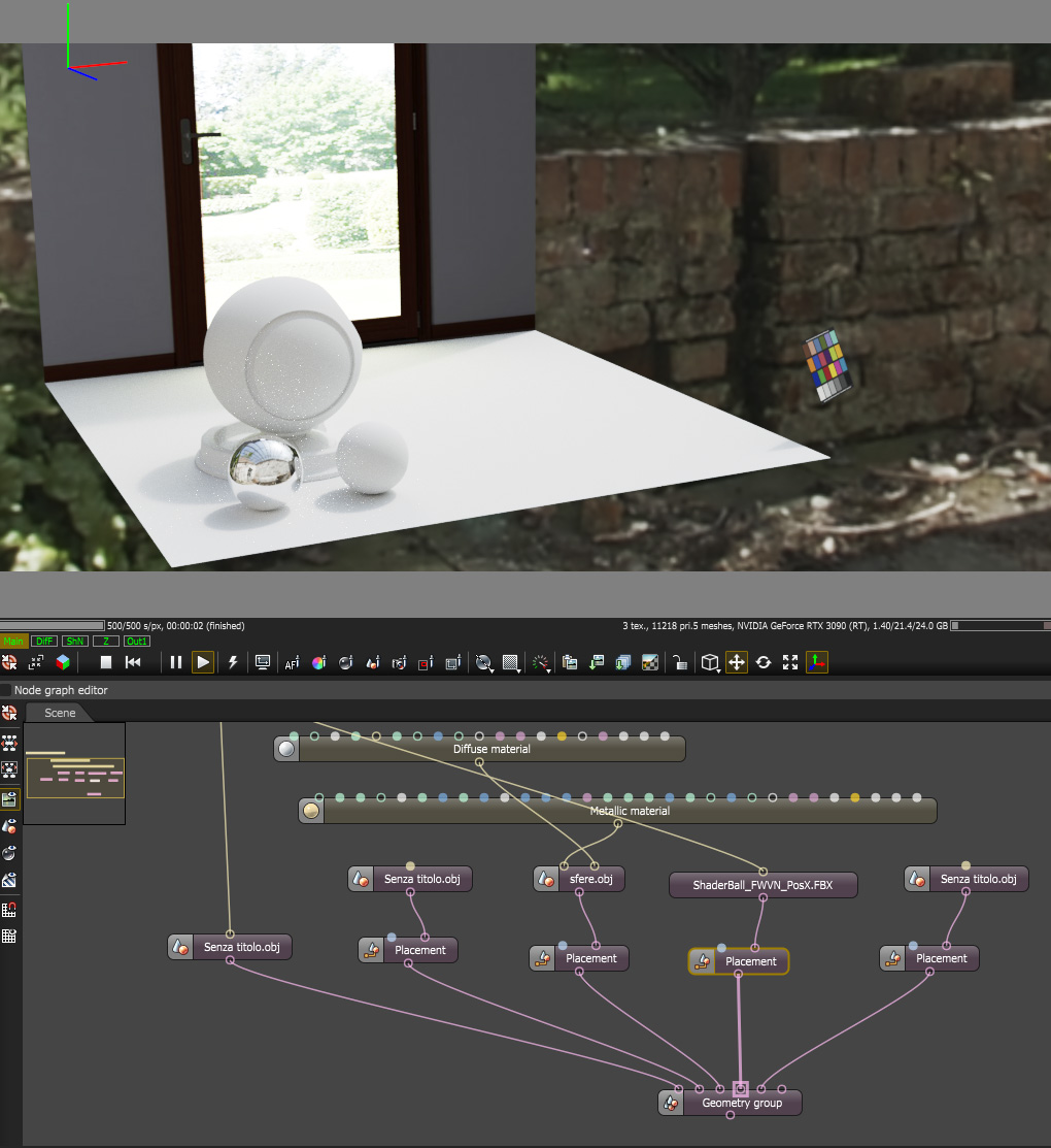

noldo wrote:https://1drv.ms/f/s!AuJBOGWzbPfe-r0jB8LsL2n_zeY_tA?e=jUYiaT
Hi noldo, the gizmo is working in both win and macOS. Are you first selecting the geo node or placement with the move gizmo active? (sorry for the silly question)
noldo
Posts: 94
Joined: Wed May 25, 2011 7:07 pm
Yes, it's active, but don't work...
I try to update video driver.

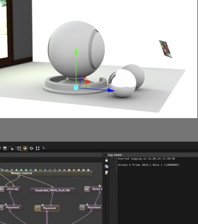

noldo
Posts: 94
I tried the drivers game and studio, with both I don't see the gizmo. It's not a big deal, I work without it.

noldo wrote:I tried the drivers game and studio, with both I don't see the gizmo. It's not a big deal, I work without it.
Hi noldo, I managed to reproduce the issue with your scene. It might have something to do with the missing render target.
If you right click the geometry group > render, the move gizmo doesn't work for any mesh or placement nodes.
We'll look into it. Thanks for the report.

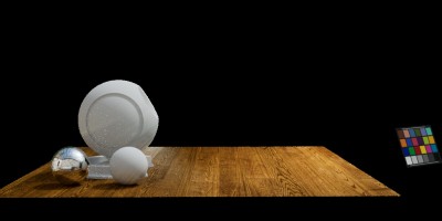

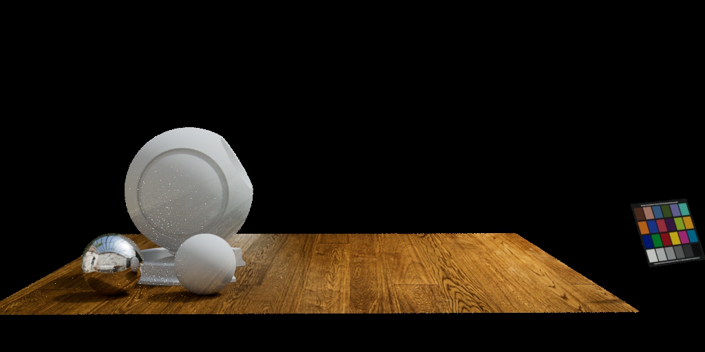

noldo
Posts: 94
Bug?
When i set a texture to the plane with "Sample pos. to UV" for matching the background, the object in the scene become semitrasparent...
I attach the scene and image sample.
Test.orbx
(28.85 MiB) Downloaded 263 times
abstrax
Posts: 5516
noldo wrote:Bug?
This projection uses the sample position in image space to calculate the UV coordinate, it's not doing an inverse transformation of a hit point into image space. For the latter you would have to use the perspective projection.
As a result, "Sample pos. to UV" should not be used for regular path tracing or it will give you results like you observed, because when a path bounces around in the scene it will always use the same UV coordinate which only depends on the pixel position of that path.
This projection was mostly added for the global texture AOVs.
