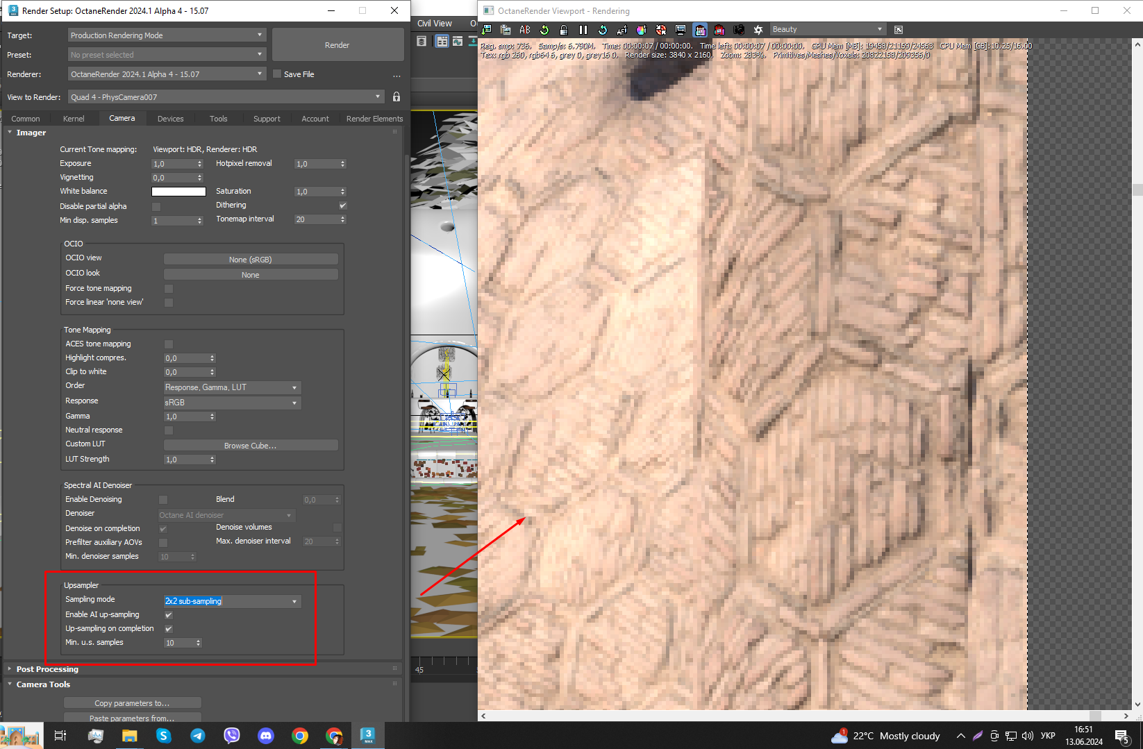

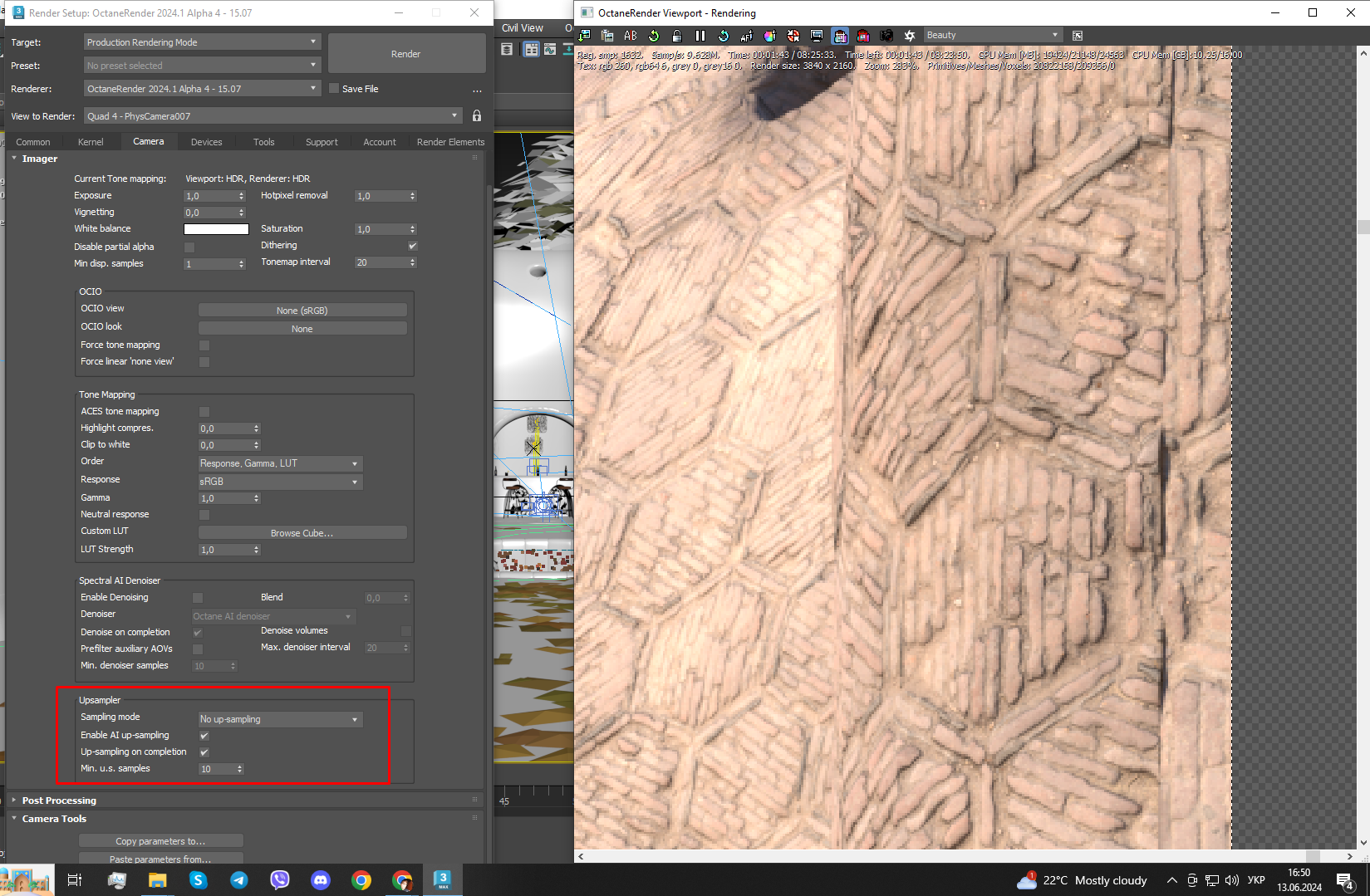

For some reason this option is enabled by default in the integration! I’ve been rendering in such poor quality for half a year now and I can’t understand why the detailing is so bad, but here’s the reason
I have never gone into this settings item, and it came as a surprise to me that the octane renders blurry.

Hi Elvis,
Wouldn't bet on it if it's set to 2x2 by default, but my setting is always set to no-upsampling. Not in your case?

Elvissuperstar007 wrote:https://render.otoy.com/forum/viewtopic.php?f=24&t=83652&start=10
I had a look and the default setting for Camera Imager Sampling mode is 'no up-sampling'.
There are no settings in Octane preferences that can change this setting by default (unlike some other kernel settings that you can change in Kernel Default tab).
You can check by starting Max, and set the renderer to Octane. (if Octane is already set as default renderer on startup, set Scanline, and then set Octane)
Then open Render setup, Camera Tab, and see the sampling mode; it should really be 'no up-sampling' at this point.
You might be using a 'maxstart.max' file..
In this case, it was probably saved with upsampling set to 2x2..
You can just change this, and re-save your maxstart.max..
Note that when you start Max, you can see if it's using maxstart.max by opening the Tools tab, rollup '1.9 version support', that shows the Current Scene filename (something like C:\Users\xxx\Documents\3ds Max 2024\scenes\maxstart.max)
If you are not using a maxstart.max file, there could be some other custom startup things (some maxscript files, ..) that can change some settings..
Could you check those things, and let us know if you still get the 2x2 by default ?
