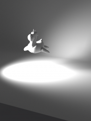

There is a bug with analytic lights and motion blur on.
with Motion blur
with Motion blur
without Motion Blur
without Motion Blur

galleon27 wrote:There is a bug with analytic lights and motion blur on.
Hi, it seems this is a core Standalone bug, I will chat to the team about it - thanks for the test scene and letting us know.
