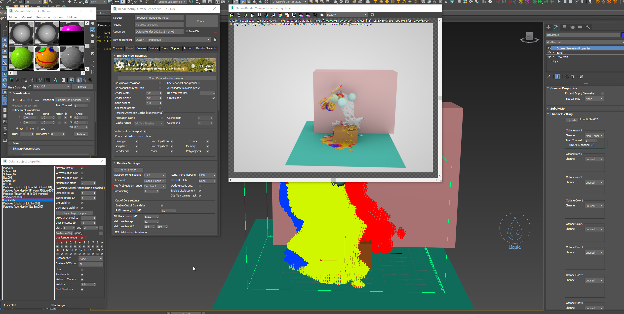

coilbook wrote:Max crashes when adding UVW map modifier to mesh while octane viewport is opened.
Hi coilbook,
Thanks for pointing out this issue.
I still couldn't get crash with Octane, but I got some crash with Vray and Arnold... especially when moving the timeline
so there are some issues when using a modifier with Phoenix meshes. I think it might come from Phoenix itself..
Here are some results of my investigations :
Using the previous sample scene, and adding a UVW map modifier, a Bend modifer and the Octane Geometry modifier:
-Vray doesn't seems to support any modifier added to the simulator / mesh. as soon as a modifier that transforms the mesh somehow, nothing is rendered.
We get the same effect with Octane with the default settings.. see below for a working setting with Octane.
-The 3dsMax viewport works a bit better, the transformed mesh can be displayed for current frame, but disappear when changing frame. disable and re-enable a modifier makes the mesh displayed correctly again.
-Arnold works much better than vray and the 3dsMax viewport.
To make the modifiers work correctly with Octane :
-The simulator object must be set with 'Use Render mode'
(Octane Object properties, when Render settings / Kernel / Render settings has 'Notify objects on Render' set to 'Per object')
(or that could be set to all objects if Render settings / Kernel / Render settings has 'Notify objects on Render' set to 'All objects', but that might bring performance issues in big scenes)
-If the Octane Geometry modifier is added, and another modifer changes the UVWs (like the UVW Map modifier),
: make sure the Octane UVW1 channel is set to Map Channel 1 (even if the information text below says 'INVALID channel 1...) [in Channel Settings panel of the Octane geometry modifier]
Here is a sample scene with a png image texture applied to the wetmap with a UVW Map modifier, and a Bend modifer too:
wetmap_UVWs.zip
(114.64 KiB) Downloaded 142 times
The different mapping modes of the UVW modifier are working correctly (Planar, Cylindrical, etc..)
Also, with the 'Use Render mode' set to the simulator, this seems to fix other update issues when changing other settings / changing the current frame.
Note that you may want to disable the 'Phoenix Issue Resolver' in Render settings / Support / Phoenix, as it sometimes open the resolver dialog incorrectly.
Those settings and issues should be improved / automatically detected in a future release..

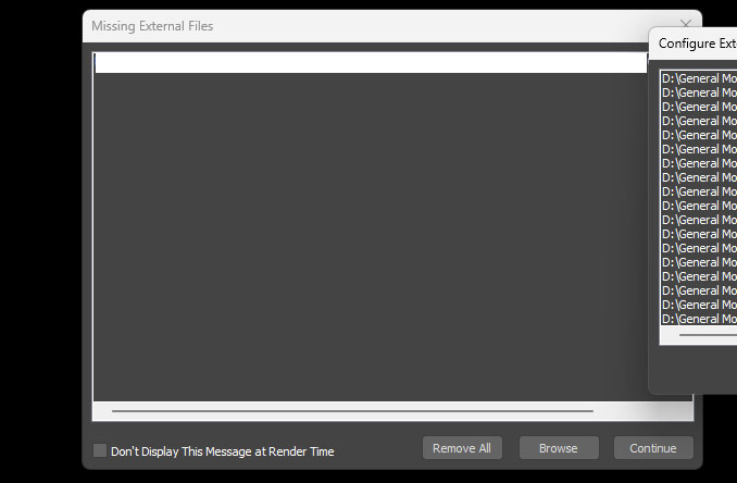

after restarting 3d max still get missing textures error. is it 3ds max or octane? I noticed old octane scenes do this a lot
Any plans to do search pc for missing textures?
UPDATE:
Missing external files dialog doesn't work with octane (after restart all bmps are missing again). One has to manually go to each octane texture with a missing path and direct octane where a bitmap is. Can this be fixed?

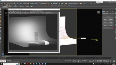

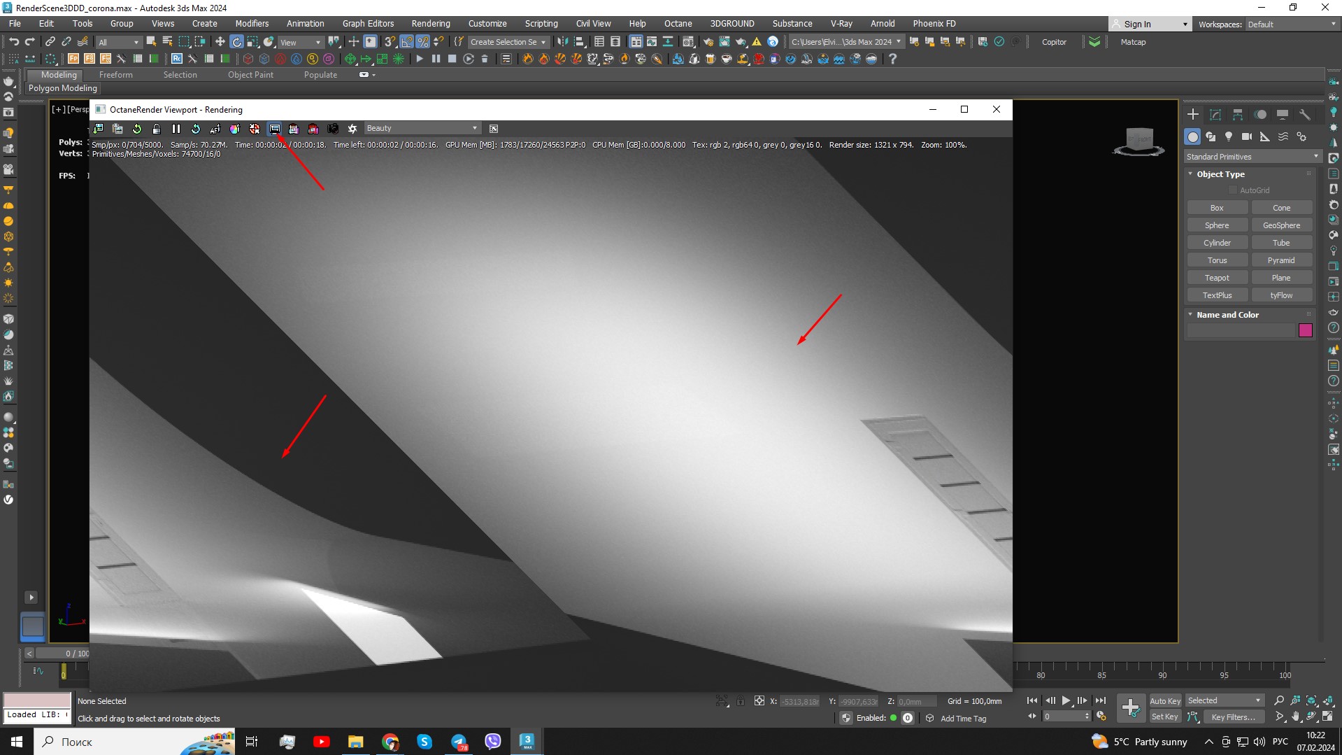

if you add HDR lighting and try to move the animation scale, the scene immediately crashes
paride4331
Posts: 3998
Hi Elvissuperstar007,
Please provide a detailed description of the process that generates the reported issues so that we can verify and address them effectively.
Regards
Paride

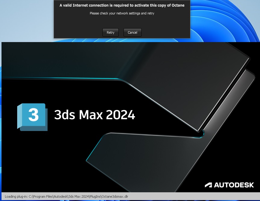

Good morning, I want extern a detail about my plugin OctaneRender for 3ds max v2023.1.2 - 14.8
Is the second time when I try to open the program and fail the OctaneRender plugin v2023.1.2 - 14.8, I don't know if is a problem of server or update by windows 11.
Add image like reference.
