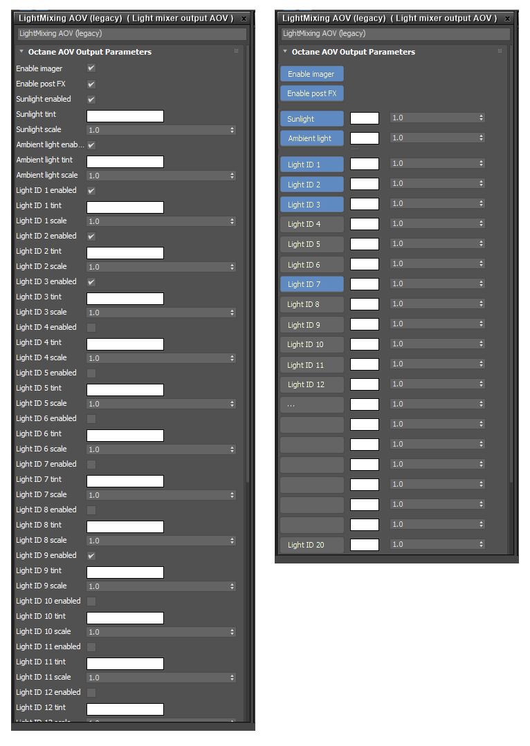

Hi !
I was using Light mixer and I wonder if we can have a more compact UI to see the controls more easelly. ;-)
Thanks !
