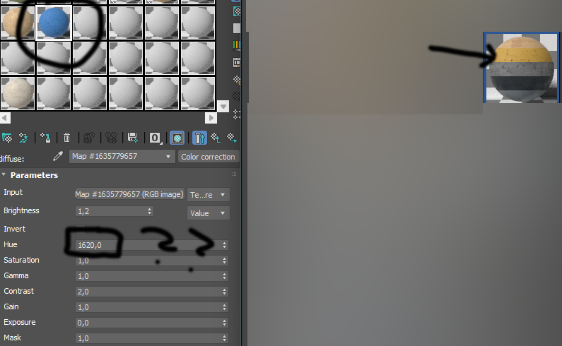

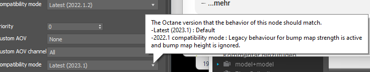

It seems my pre 2023.1 materials are set to the current version by default. This causes my errors.
Another issue I experience is a color shift in my colorcorrection node. The HUE shifts from 0.9 to another value making my material blue.
It happens after I apply it from my material library to the Material Editor.

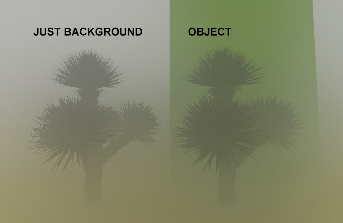

I tried new fog post volume effects.
When a complex object with thin parts ( tree,..) is detached against the sky ( alpha ) there is problems in anti aliasing or something.
When there is an object behind it is ok.

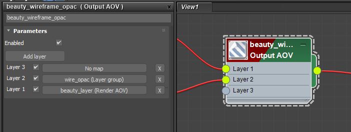

Hi !
When using Output AOV it is very annoying to have layers listed not in the same order.

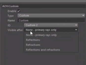

Hi !
In c4d when using AOVs you can choose rendering options. Actually in MAX it is " Primary rays only"
Is there in MAX such options ? I can't see nor in Octane Objects properties nor in Output AOV graph.
This is very usefull.

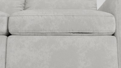

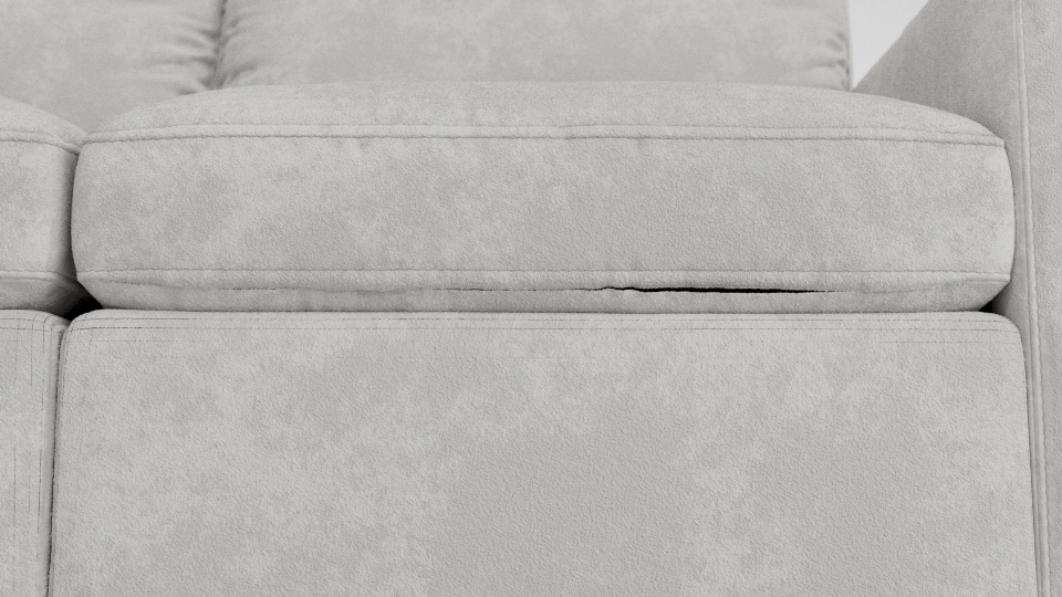

what about to improve the displacement to not break the mesh geometries? Like the next example:
I hope Otoy put more attention to improve actual features...
