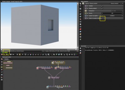

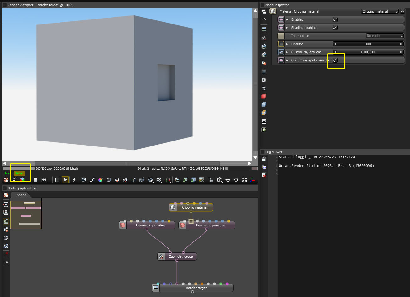

SSmolak wrote:Denoiser completely doesn't work with clipped materials - it render them as transparent :
It works fine only when Alpha Channel is enabled in Kernel settings and Custom Ray Epsilon is disabled in Clipped Material.
This also works in the attached test. You'll need to start providing scenes for us to look at.
denoise_clip_test_001.ocs
(58.14 KiB) Downloaded 146 times

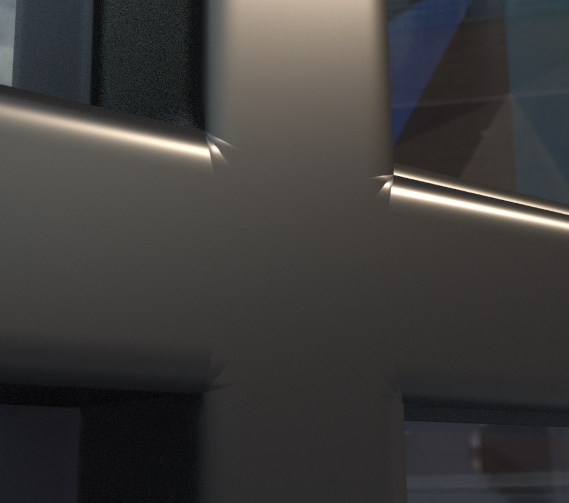

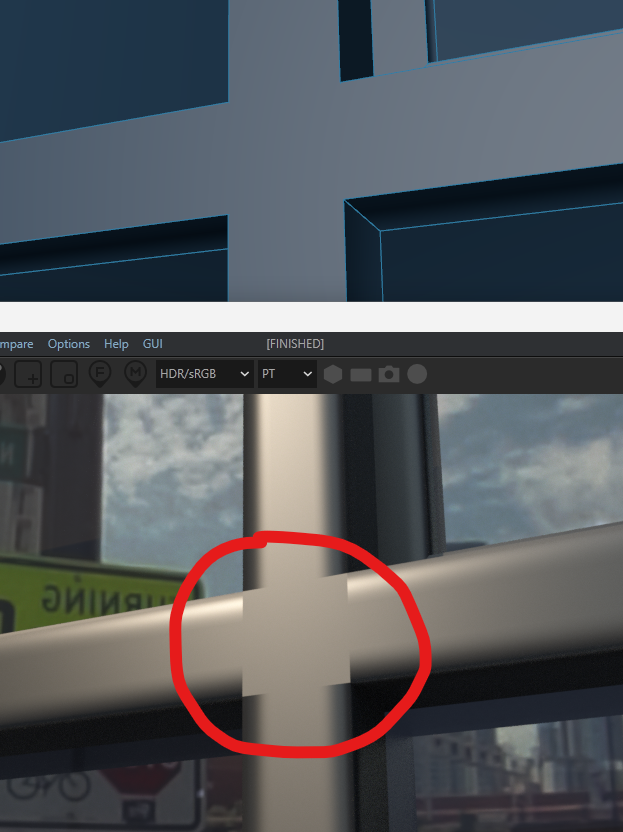

Round Edge issue :
Increasing samples produce strange effect :
Architectural Visualizations http://www.archviz-4d.studio

Thanks, will have a look.
