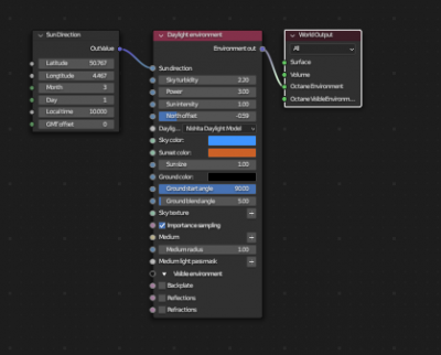

2) And I know that this is a very scene dependent value, but would this light bright be considered bright enough? This is how I'm lighting this scene
Light Strength
Light Strength
Thank you again for all your answers!

timAugustine wrote: 2) And I know that this is a very scene dependent value, but would this light bright be considered bright enough? This is how I'm lighting this scene
This is the way. It depends on several factors. Some scenes can go as high as 10 or even 30 tops, by adjusting exposure accordingly. 3, 5 is fine.
